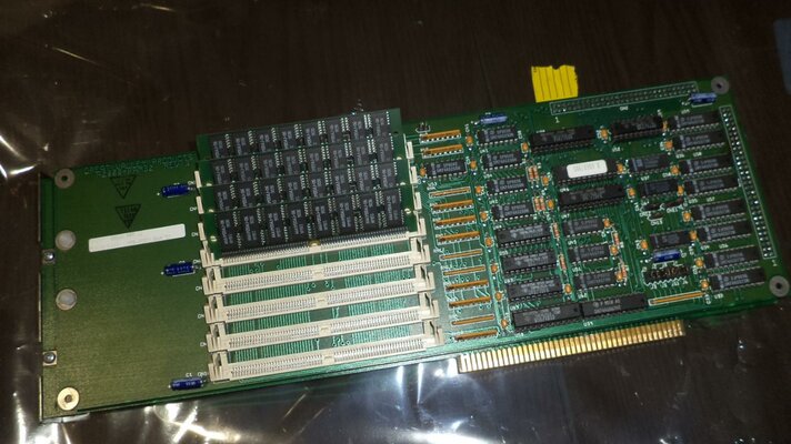

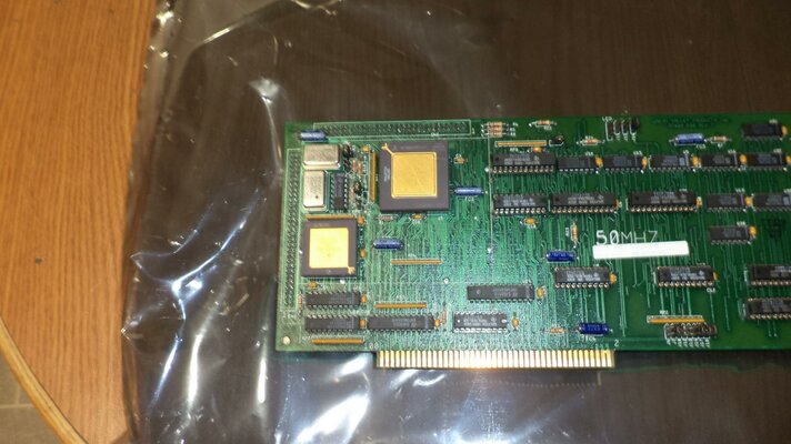

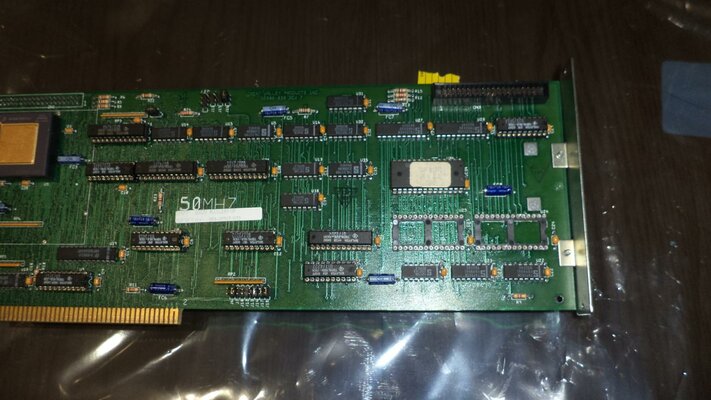

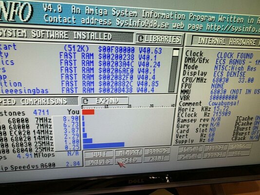

I have a GVP 3001 Series II 68030 Accelerator card for the 2000 (With IDE connector), and has the ram card too (4Mb). But for some reason it ain't working now. It was working for the seller (See Pics). Though, I can't get it to work on my 2000 (Black screen) The CPU (40MHz) gets warm and chips on the board and ram board get warm too, so I don't know if it's the slot on my 2000 board (I've never had a Accelerator card in it before) .. I haven't messed with any of the jumper's.. Shame because I have ordered another 4MB of ram... Maybe you can get it working...
Oh, I got a guy here making me a v3.3 of the IDE ROM, so with the extra ram coming.. I'll send it on when I've received them...
