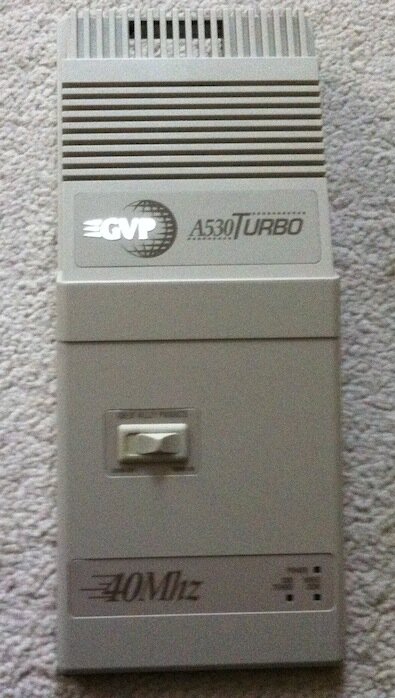

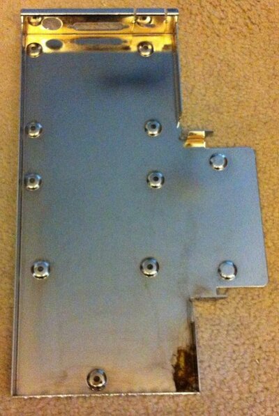

Next up on this project then is to turn my attention to the case.
The original pictured earlier in the thread was in good shape overall, but not *quite* where I wanted it to be for the perfect job. I admit to being a perfectionist in a lot of areas; I dont see that as a bad thing either.
So, next was an order placed here on the forums through user GVP_SALES. Earlier this year he posted a sales thread offering brand new NOS A530 covers. That was a real stroke of luck then!
I sent for a box of GVP bits and pieces from him, including one of these covers.

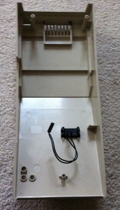

So, first off the new cover. Once again, the light levels are not perfect; the cover is spot on though :
And underneath. Obviously here you can see the cooling fan (more on than in a bit) and the wire connector for the Turbo Switch. This basically switches the expansion of the unit off or on :
Now, although the cover is NOS and in great condition, the fan has always been an issue for me. The existing ones are 15-20 years old, and while I would say they are adequate in what they do, Im going to do better. They were good for the standards back in the day of course.

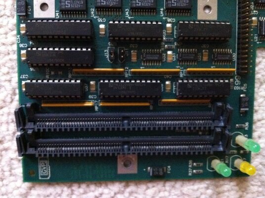

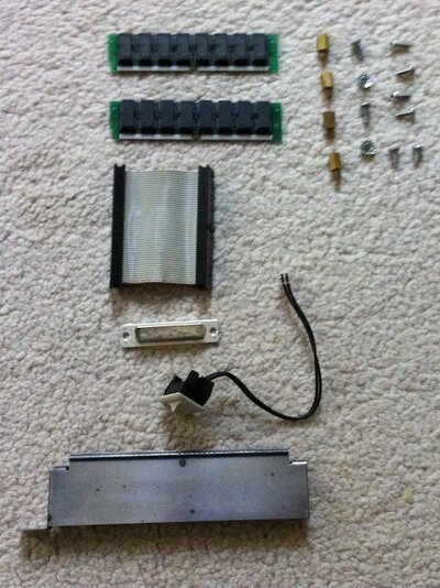

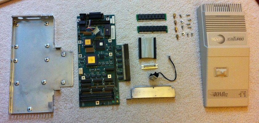

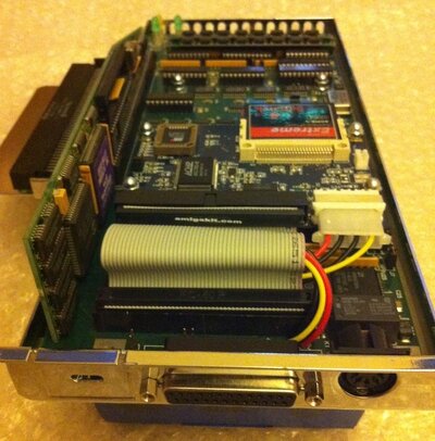

Ok, so a small update here this evening.
I mentioned previously about a further small idea I had for improving the cooling. Its quite simple really but will aid in keeping the whole unit cool.

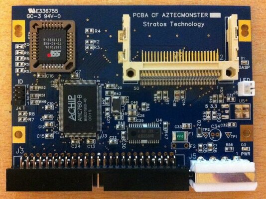

The previous machanical hard disk, and the subsequent Aztec Monster I replaced it with were both mounted internally on a small set of brass standoffs, exactly the same as you would find in your PC case to fix the motherboard in.
Its good that GVP used this method and not some proprietory fixing instead.
Now the existing standoffs were fairly standard 12mm ones. The thing I noticed was that the clearance between the top of the processors and the underside of the disk unit was only a couple of millimetres. Although its not touching at any part, that doesnt exactly allow for much airflow.
As you can guess, there is a fairly simple solution to this ;)
I sent off (Using the other bay) for extra length standoffs. You couldnt possibly use these for a normal motherboard but they are made from the same material and in the same style.
Since the PCB was away for some work to be done on it, I took a slight guess at the required size, but just to be sure I ordered 2 packs; 1 set at 25mm and another set at 30mm.
They arrived looking a bit grubby and all, but were just what I wanted :
After a quick check, its the 25mm ones that will do the job just right :
Like everything else on this project, they need to be as near to perfect as possible. So, before fitting, a quick rub and buff with some wadding polish produces a clean and very shiny end result :
First of all we attach them through holes in the PCB and through the base, and this gives a nice solid fix with them :
And now we simply reattach the disk drive assembly by sitting it on top of these spacers, then fasten it down with those cap nuts I used before. Note now the amount of space between the top of the processors and the disk assembly. This will allow the best level of airflow over those processors and help keep them nice and cool :
A quick side view, lots of room under there, and it also provides plenty of space at the back where you can just see the socketed rom chip. We'll need that extra room there later on.....
The disk assembly itself and the space that now exists beneath it is perfect for this job. Very pleased with it.

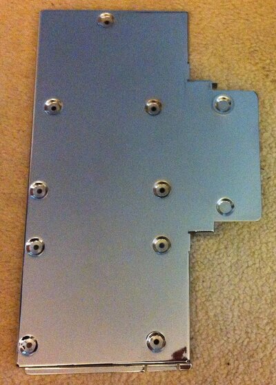

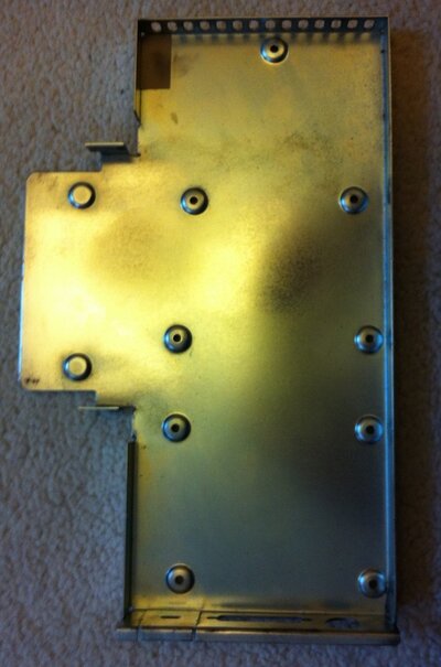

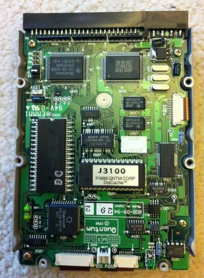

Well after all the work so far, I hit a small snag.
The PCB of the disk assembly I am using started to short, and was causing the unit to reset or go into some kind of sleeping state. The only option was to reboot.
Its been suggested on a short thread in AmiOracle to replace those brass standoffs with plastic ones, which may have worked but I wasnt too happy with switching to those.
After i bit of playing about I found the location of the short, and its actually a simple fix.
First of all, I cut some 5mm sections from some old wiring sheath that I had to hand :
Then slid these over the threads on the brass standoffs. I then put the PCB back in position and fastened it down with the cap nuts again. Notice these cap nuts are different to the originals; I sent for a couple of different sets and these work a little better :
It was this corner where the short was occurring. By screwing those cap nuts down fairly tight, its had the effect of squashing the insulation outwards and filling the gaps between standoff and PCB. So it now has a nice tight fix and is fully insulated. Thats put an end to the shorts happening :
Its now back on track and almost complete !

Then I removed the old fan from the case. See how deep the fan is; it takes up precious space inside the casing :
After removal, this leaves a nice little collar that has little studs on it to keep the fan in position. These line up perfectly with the new fan :
A couple of spots of superglue and the new fan is attached perfectly :
The finished work, casing ready to be attached to the main unit :
A quick check, and all is working well. I can barely hear the fan, just as it should be :

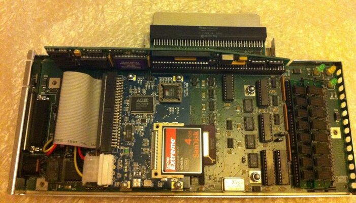

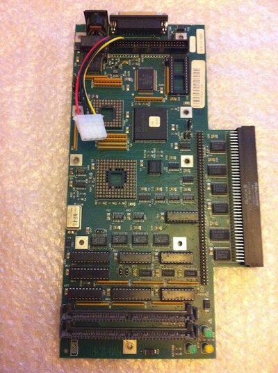

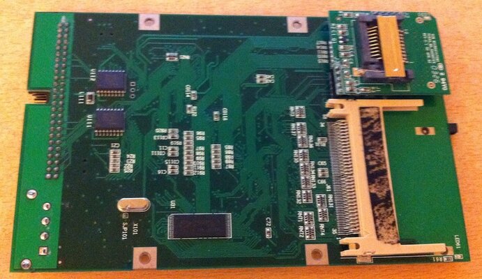

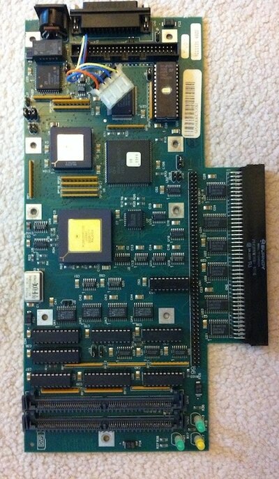

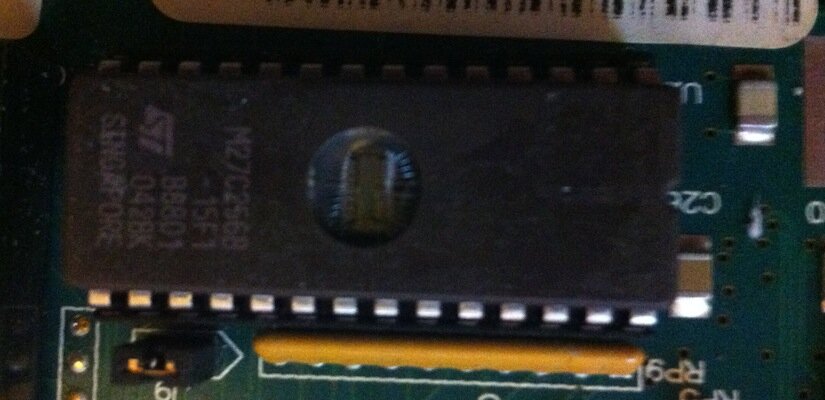

Next up is something Ive been working on for a while; and that is performance.

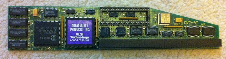

After reading several forums around the web, the general opinion is that the scsi controllers on some GVP kit isnt the fastest, this is particularly the case with these sidecar units.
Some time ago, after reading about the guru rom chip, I acquired the GVP version of one of these right here in the Sales forum. It came with the adaptor and 2 versions of the actual chip itself; 6.9 and 6.10. Here you can see it together with a generic 4.15 rom, which was burned using the rom image from the babel.de website :
For testing, I used six scenarios;
4.15 rom - FFS
4.15 rom - SFS
Guru rom 6.9 - FFS
Guru rom 6.9 - SFS
Guru rom 6.10 - FFS
Guru rom 6.10 - SFS
Checking each one of these setups using SysSpeed, I got exactly the same result every time; that was a transfer rate of around 1Mb/Sec. The 2 versions of the Guru rom made no difference to performance whatsoever.
In general use, it feels quite fast and snappy in any case, but Ive not been able to get any further performance improvement. Still, the existing performance is good enough !
In the end then I went with the generic 4.15 rom; this is obviously lower profile. When fitted, you can also notice how much space there is around the components overall, which aids in keeping the unit cool :

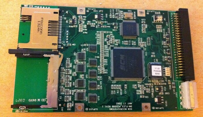

Assembly for the final time then; fit the PC286 board in there and shes ready to go :
great work here:thumbsup:
i thought the later roms were more stable and gave upto 3.5meg transfer rates?
also the Guru rom gives you access to larger hard drives (I wanna Guru rom, but no one has one:()
Well I was of that thought too.
The changes from 6.10 upwards apparently were very minor and didnt have an effect on performance.
As to the larger hard drive size, I found no difference at all when setting it up. The various partitioning tools still reported incorrect sizes but allowed me to parition it anyway.
I really couldnt see any difference at all from using the guru rom as opposed to the generic 4.15.

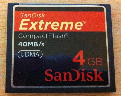

There is a 4Gb CF card in there and I still have access to the entire drive. Thats more than enough for the needs I have with this unit. :)
