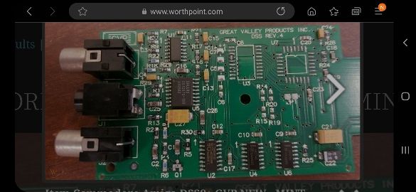

Hi, I want to recap the tantalum caps on a dss8+. I could find almost all parts due to the Marking on the top side of the tantalum caps, except for C3, C4 and C24. My dss8+ is a revsion where these 3 caps are in Black and the marking does not refer to the value but to the datecode only. There are dss8+ revisions with these 3 caps in yellow. See picture c3 and c4 are top left next to audio connector and c24 top right in yellow. Hopefully there is a marking that refers to cap values but picture I found is not high enough in resolution. Anybody who could help with high res picture or the markings or better a capacitor list ? Thanks.
Verstuurd vanaf mijn SM-A505FN met Tapatalk
Found a higher resolution picture and was able to gind out the cap value. So ordered the tantalum smd replacement caps.
