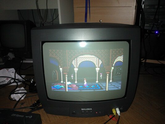

Problem solved. The uiec didn't like my 64 MB MMC cards. When I tried with an SD card, everything worked. I also managed to write the Prince of Persia .crt on my EasyFlash module. Yay! Finally something that I've assembled works! :D

Edit: Here are a couple of pics of the EasyFlash being flashed and Prince of Persia running on real C64.
