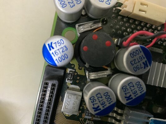

Boing-ball Well-known member AmiBayer Joined Nov 17, 2023 Posts 2,136 Country United Kingdom Region London Mar 2, 2024 #1 Hi all, Hopefully being posted in the right are. I’m trying to work out and source this type of capacitor. K750 16T23 1000. Have tried Google, Mouser and dare I say it ebay. But nothing can be concluded. Anyone know. Have attached a picture. Cheers. Attachments image.jpg 250 KB · Views: 13

aaronkatrini Well-known member AmiBayer Joined Dec 25, 2018 Posts 2,935 Country Italy Region Rome Mar 2, 2024 #2 K750 most likely stands for Kemet 750 series Polymer Aluminum cap capacitor. By the shape seems 1000uF / 16V.

miggymad Current HTTP status code: 418 Assistant AmiBayer Joined Aug 1, 2019 Posts 2,696 Country United Kingdom Region Central Mar 2, 2024 #3 Here you go ..! Mouser Link Last edited: Mar 2, 2024
Boing-ball Well-known member AmiBayer Joined Nov 17, 2023 Posts 2,136 Country United Kingdom Region London Mar 2, 2024 #4 miggymad said: Here you go ..! Mouser Link View attachment 2479704 Click to expand... Thanks All Have now ordered them from Mouser Cheers Miggymad Last edited: Mar 2, 2024
