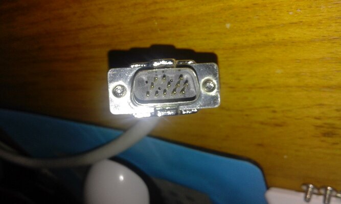

I got this 486-DX machine with a crt monitor and it sem'd to all of its used life being hooked up along the computer, but i wanna someway use it alone without turning on the computer , is there a possible way? i wanna use it for playing pixelated game's on my newer computer, but it doesnt use the standart blue vga connector, how can i apply power to it with not needing the computer? and its 15 inch
It looks like a standard DE15 vga connector to me. What's the issue--is the monitor physically connected to a computer and thus doesn't have its own power connector? It's not sure what you're asking here.

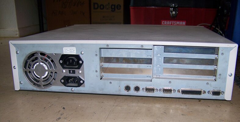

most older AT (486) computers had this plug,(my Pentium 233 has it)
1, turned on the monitor with the PC power switch,
2, saved you using another power lead.
back of your 486.

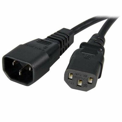

lead you need to connect monitor power to back of 486
I'm not 100% sure what are you talking about. If PSU unit on your computer have two power plugs (C13 and C14: https://en.wikipedia.org/wiki/IEC_60320#C13.2FC14_coupler ) then you just need cable to connect your monitor to the power main.

Sardine was more correct on it, thats the kind of 486 i have, the slot's are vertica insted of horizontal.
