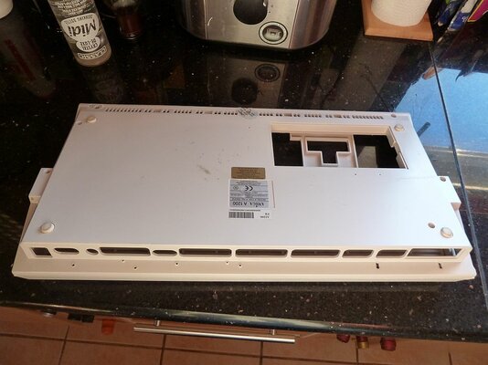

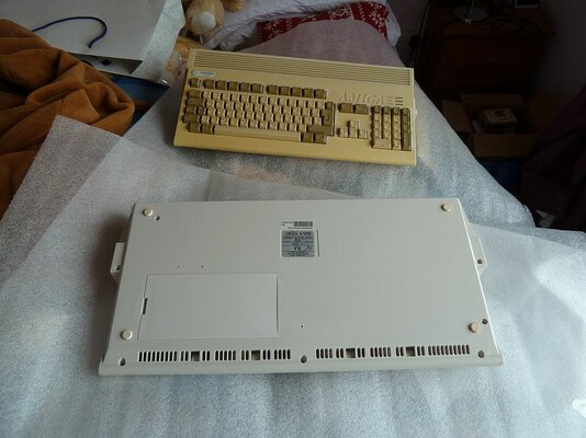

Thanks for the suggestion John and ScarrySphinx. I tried the brown one in the background and it's come out pretty good as well after one session :thumbsup:
Keys aren't looking too bad either
After all that hard work I had to go inside and watch some Countdown.... (I like to think it helps with my IQ :lol:)

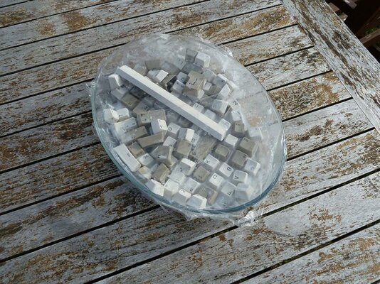

I think the keys turned well in the end. I'll let them dry out, repair the 3 I damaged and then clear coat them :thumbsup:

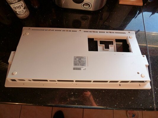

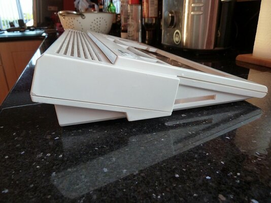

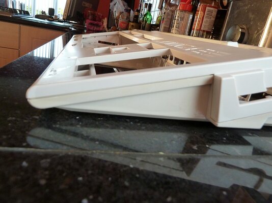

Sadly the case was a bit of a mixed bag... I remember Merlin saying Retr0bright could only do so much and while the top is going but the bottom half :huh: One side looks good but the other half is just too far gone I guess :picard
Still, thank God for Scrappysphinx sending me a freebee with the other case I bought :thumbsup: Ignoring the extra air holes from some botched mod it's white and scrubbed up really well :thumbsup2::thumbsup2:

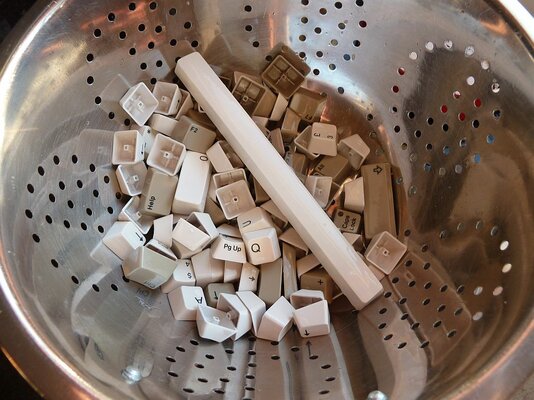

How many bottles of the undiluted BBlonde for just a 1200's keys?
Nipped into local Superdrug yesterday and bought 2 thinking I was going to have to mix them with something else. If using neat then surely more than 2 bottles required?
Thanks.
Nope, one bottle should be enough, you only need a thin coating of it, you aren't plastering. :lol:

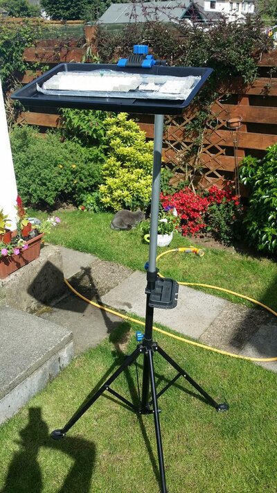

Hoping some very rare west central Scottish sun will do a job today. The stand is a cycle maintenance stand from Lidl, something like £20, very versatile and holds bikes too :-D
