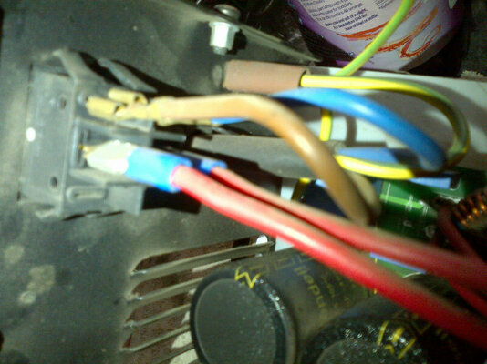

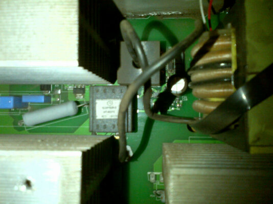

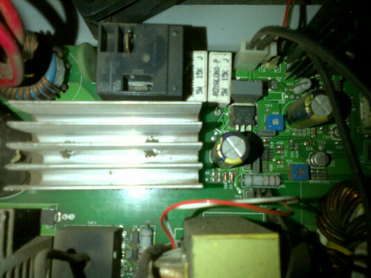

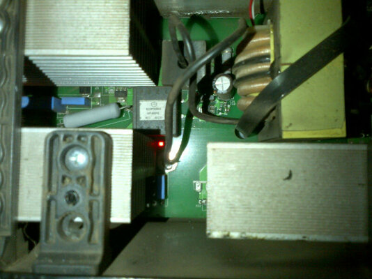

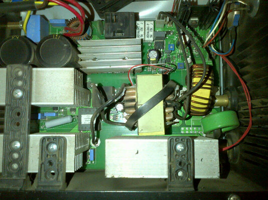

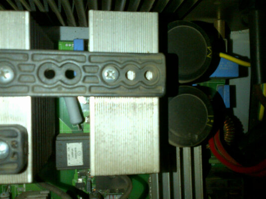

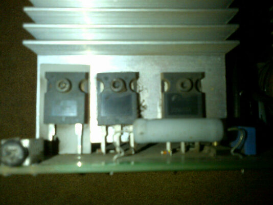

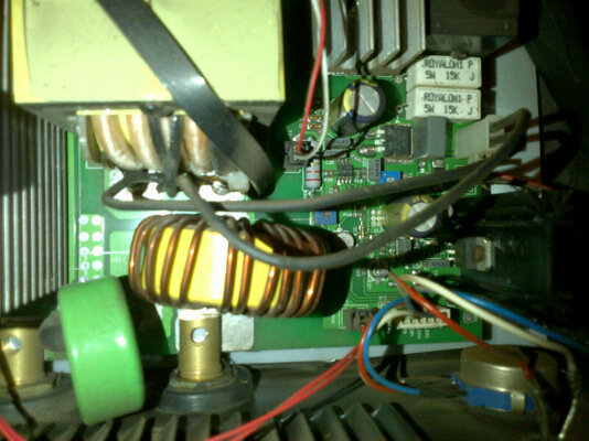

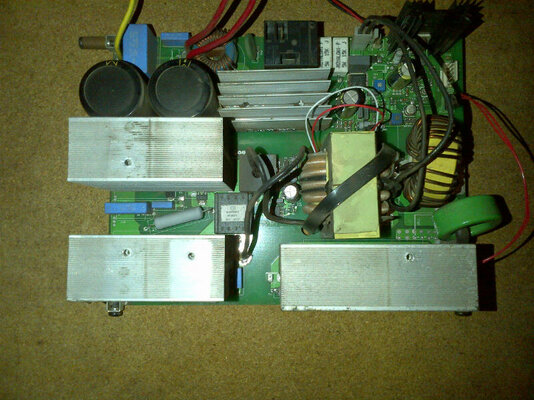

OK, here's where it gets picture heavy, for Bryce and Justin's benefit. Here are some gratuitous nekkid shots of the board from the Kilmak machine, as this was the easiest to remove.
Manchester-20150206-00304_zpsd5cf4d46.jpgManchester-20150206-00305_zps1c2ce9c0.jpgManchester-20150206-00306_zpsce6fb6bc.jpgManchester-20150206-00310_zps0cfee584.jpgManchester-20150206-00309_zpsba11270f.jpgManchester-20150206-00308_zpse1280899.jpgManchester-20150206-00311_zps2c3d9468.jpgManchester-20150206-00307_zps51762998.jpgManchester-20150207-00317_zps3dffbd7b.jpgManchester-20150207-00312_zps305e101c.jpg
The header to the top right of the main board picture is where the voltage select pot and the power/ temp overload LEDs connect.
Now, this is what I've found out by examining the board and it's components. The two heat sinks that are together both have 1 x STTH3006 High Voltage Rectifier and 2 x 20N60A4 High Power Switching MOSFETs on them, they are identical.
The single heat sink has a bank of 6 x MBR20200CT High Voltage Schottky Rectifiers. There are also LM317T adjustable regulator and an LM317D2 Voltage Regulator.
I've also found an LM393M Dual Differential Comparator that is located near the LM317T and another LED, that probably should be working but isn't at the moment.
The board layout does appear to be similar to several Chinese-built welder inverter boards but it's not identical to any of the ones I've seen from searching.
Does any of this help, in locating likely suspects for the failed components?

I think it's fixed. I replaced all of the Schottky diodes, the LM317 and found a resistor that had died . The markings on the resistor had been vaporised, but a member on another forum who speaks Turkish rang them and got the details.
One 2R2, 7 Watt wirewound resistor later and it has coughed into life! I'll try some test welds later this week but for now, I'm just happy that it's powered up, the temperature warning goes out and the fan seems to work as it should.
