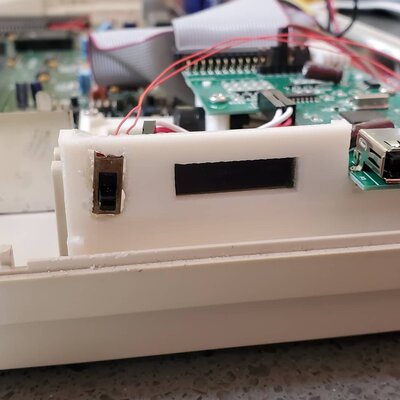

Modded my NTSC Amiga with a Switch so I Can Toggle Between NTSC and PAL

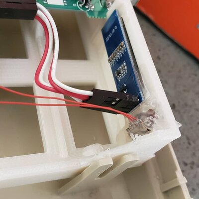

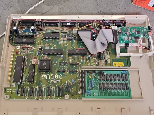

I modded my NTSC Commodore Amiga 500 today. I added a switch to change between NTSC and PAL! No holes in the case since I drilled into the 3D printed holder for the Gotek floppy drive emulator. It looks a little sloppy here but it's inside the floppy drive bay so you can't really see it assembled. You just stick a pen into the floppy drive bay to poke the switch and flip regions (and then reboot). The hot glue is just to hold the wires in place. I used very thin wire so it's all pretty clean (except for my drilling the hole in the Gotek holder!)
