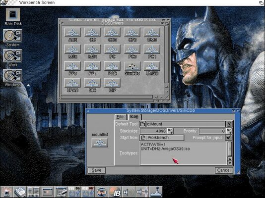

An easy way is to keep the SimCD0 intact and just edit the Icon tooltypes as following:
It works like a charm for me.
