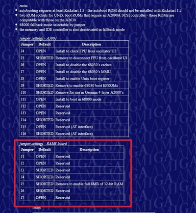

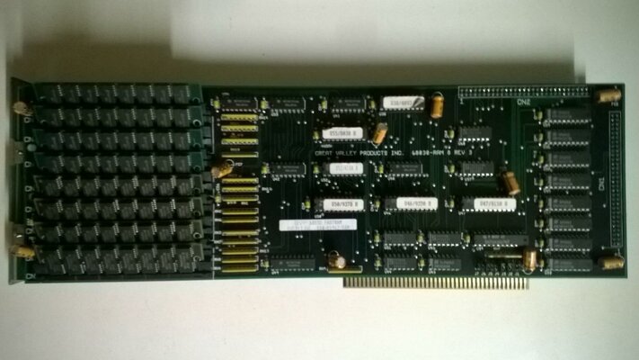

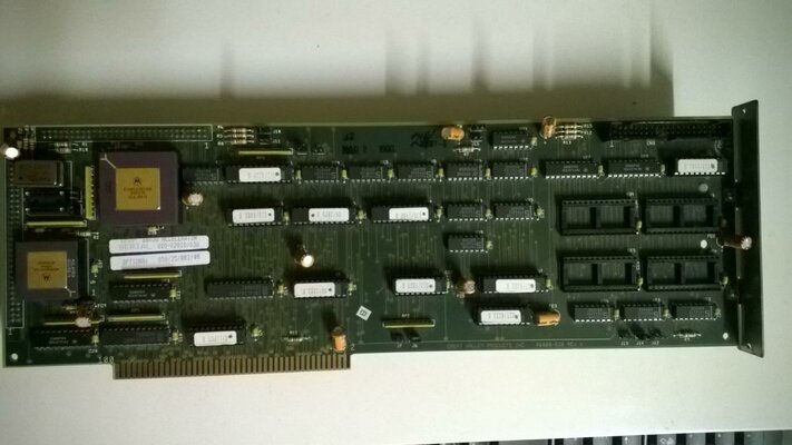

I haven't found any info for jumper settings for my A2000 accelerator, it is a GVP Impact A3001 Series 1, not a series 2.
Big book of Amiga hardware has a pictures of it, but not a jumper settings. http://www.bigbookofamigahardware.co...ct.aspx?id=180
Amiga.resource.cx
has two entries for this card, original and series 2. It has a jumper settings
for series 2 card and RAM32 module, but not for series 1 card and RAM8
module.
http://amiga.resource.cx/exp/a3001
http://amiga.resource.cx/exp/a3001mk2
With google I have found some questions for this, BUT all answers point allways for series 2
accelerator and RAM32.
Serie 2 card jumper settings doesn't help me.
Not sure where you are looking on Amiga.resource.cx they have jumper settings for the RAM8 board in the http://amiga.resource.cx/exp/a3001 page:
I've circled it in red to highlight it. Is this what you were looking for?
I was looking them from there
are they updated page just few days ago?

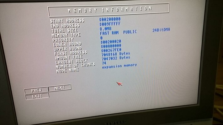

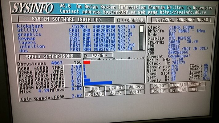

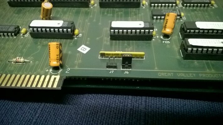

Just wondering, cache / MMU jumpers doesn't seems to work as descripted. My board is jumpered so that caches should
be disabled, but they are not.
There is a MMU
Also memory board is jumpered so that ram should be mapped to 32 bit space, but it uses 24bit Zorro II scape.
I really would like to know if I can use MMU to map memory away from Zorro II space. Wondering why and how only 50mhz version of card uses it own address space.
