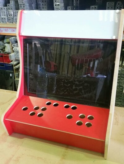

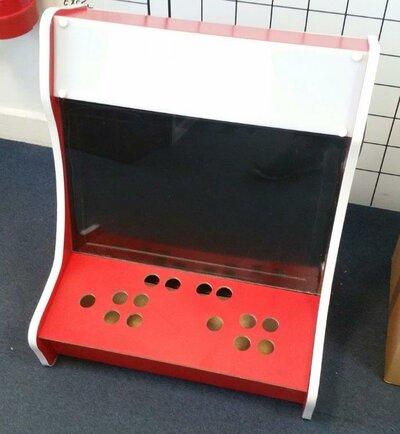

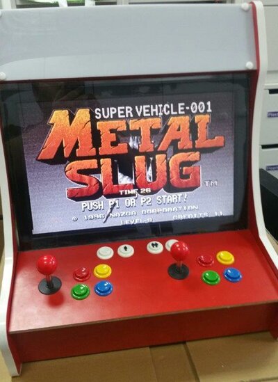

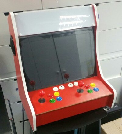

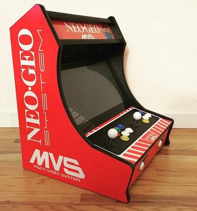

I've been threatening to do this for the longest time! But finally we have some R&D time at work so made a start on the Neo Geo Bartop, I hope to have this ready for Geek in March.

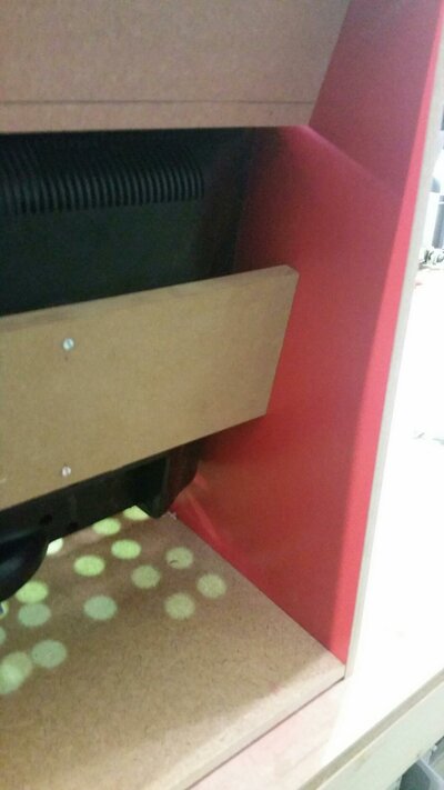

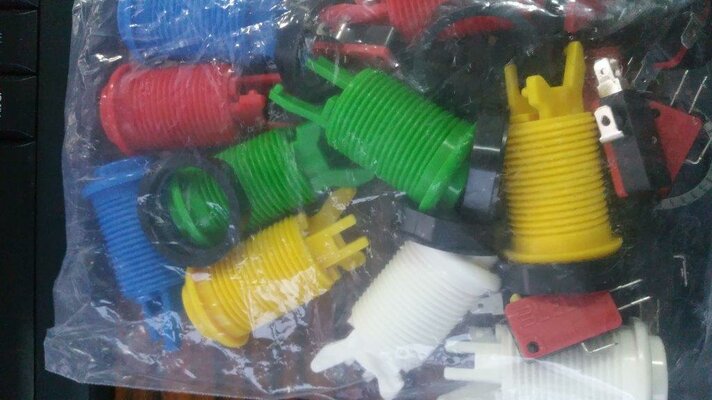

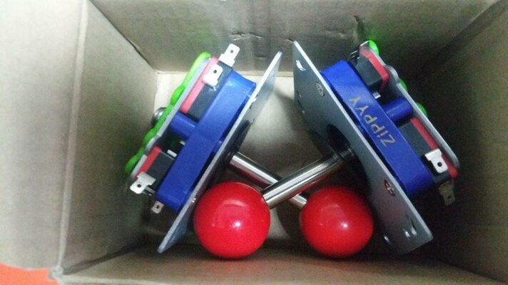

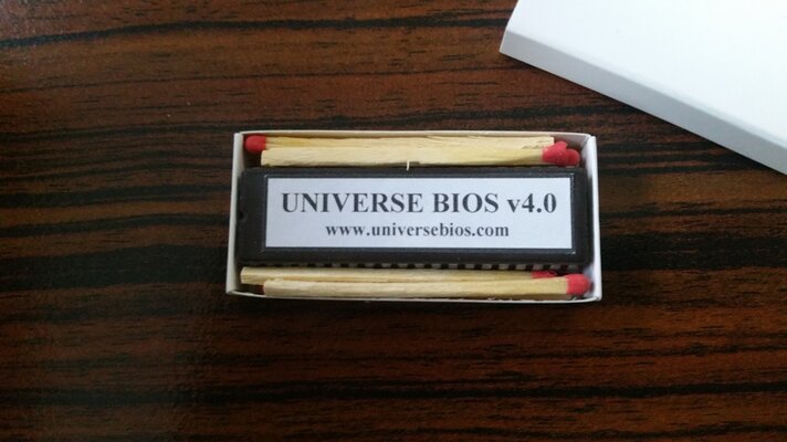

I'm waiting for a few bits to arrive such as UniBios and some buttons. We're going to laminate the cab in red and use acrylic for the top part with LED's behind, we're going to cut the white lettering on vinyl and apply to the sides (we have a plotter) the only part to print will be a Neo Geo Logo somewhere. Maybe for the acrylic so that is lights up through. There's acrylic over the screen too, we're going to try a faded edge surround using a series dots on the plotter, hopefully will work!

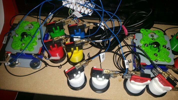

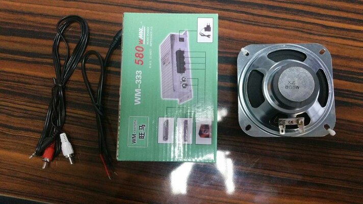

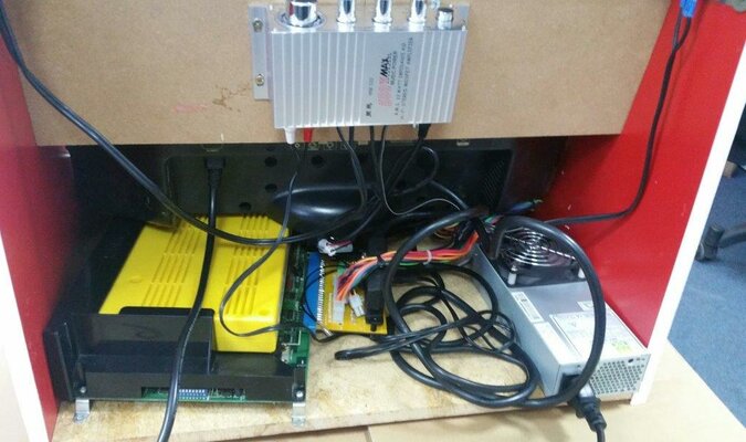

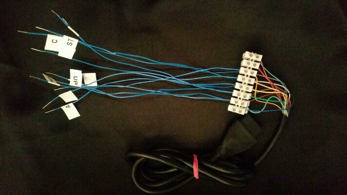

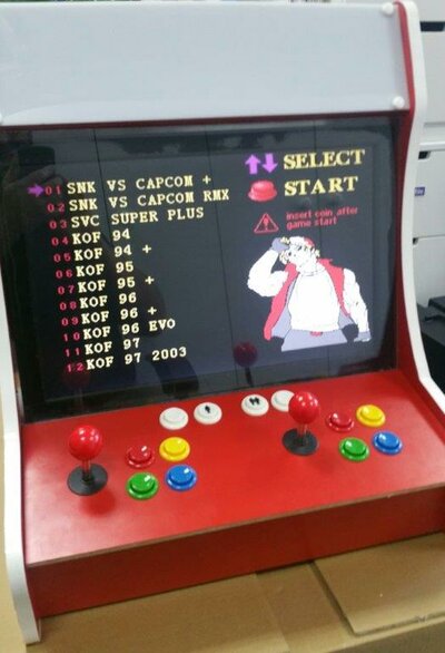

Going to mount the mini amp on the back of the cross section for the screen, using controller extension cables to wire up the buttons and stick. Select will offer coin function once I get the UniBios
