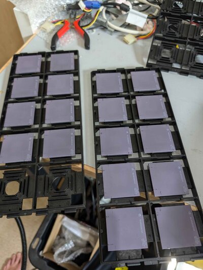

I've recently acquired eighteen (18) full rev6 68060 CPUs, with VERY strange markings.
1. They are marked as (M) MC68060RC60 (Motorola not Freescale)
2. They have a previously unseen mask (13E27K), and spacing between the (M) logo and text seems... off? (Then again, Freescale spacing was similar)
3. They came on a tray (means nothing) when purchasing in bulk
4. I am 2-for-2 on tests (TF4060 in an A4000 and BFG9060 in an AA3000+) showing those two samples to be genuine rev6 in Amiga Test Kit, WhichAmiga, etc
Super weird! I'm in the process of heat-sink+fan and checking for POV Fish test results at various speeds
I've been looking at those weird ones on ebay for awhile. I assumed they were remarked. Looks like you bought them all. Nice score!
And very interesting.
lemme know if you need one ;)
Interesting!
If not already done, please take a look at this page and compare not only the mask, but also the 00x number in the left bottom corner.
On another page (German) similar marking and mask to what you've purchased is listed as non-existing and faked - number 5.
The employees of Motorola are very mysterious guys ;-) They did a lot of different interesting things and didn't tell anyone about it, because they weren't obliged to do it :)))
