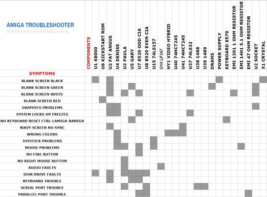

Floppy drives not reading is all pointing towards a faulty CIA chip, possibly the odd CIA. I doubt that both floppies would fail at exactly the same time. You might find this troubleshooting chart useful.

DISK DRIVE PROBLEMS
Clean heads and check for excess dust in drive. Clean out dust and try again. This may eliminate the problem. In the followings tests, a known good drive should be substituted to eliminate the drive as the source of the problem.
  1. Internal/external drive not recognized. Probable causes:
    • 8520 U8 Even CIA (U301 A2000)
    • F4 4 amp pico fuse bad (A2000)
    • F3 4 amp pico fuse bad (A2000)
  2. Motor problem
    • 5719 U5 Gary (U102 A2000)
    • 74LS38 U 36 (U203 A2000)
  3. Not recognizing disk change:
    • 8520 U7 Odd CIA (U300 A2000)
  4. Write protect problems:
  5. Read/Write errors:
    • 8364 Paula U3 (U200 A2000)
    • 68000 U1 (U100 A2000)
    • 8370 – 8372/8375 U2 (U101 A2000)
  6. DF1 A2000 not recognized:
    • J301 open (must have jumper installed)
    • 8520 U301
    • 74F00 U900
    • 74LS74 U108
