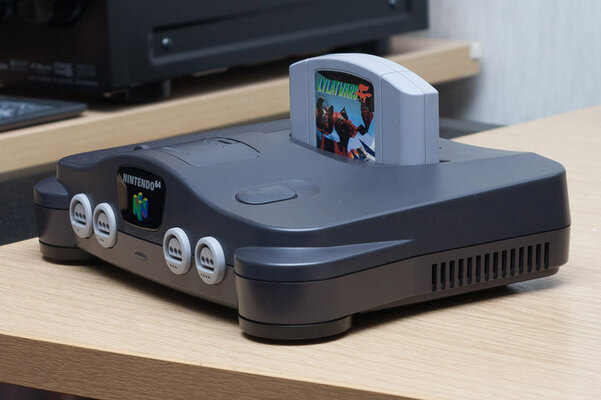

It's arrived and working okay through RF (last resort connection), but when I try to use the RGB cable from the N64 I am replacing I get a ghosted image out of it but the sound is fine. That cable used to work perfectly with my old console, has anyone got any idea why this is happening?
I have checked you can not use a modified cable only, the board has to be modified to use RGB , also you should never use an NTSC modified cable on a PAL it will cause damage.
