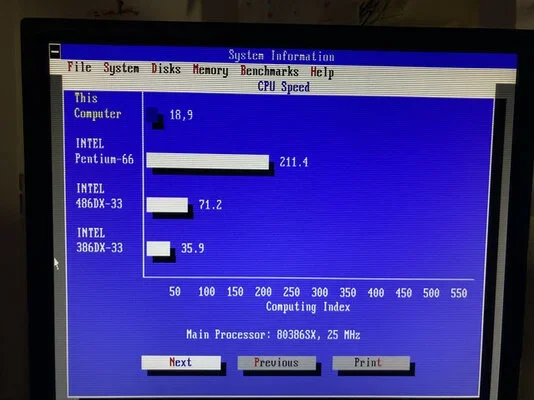

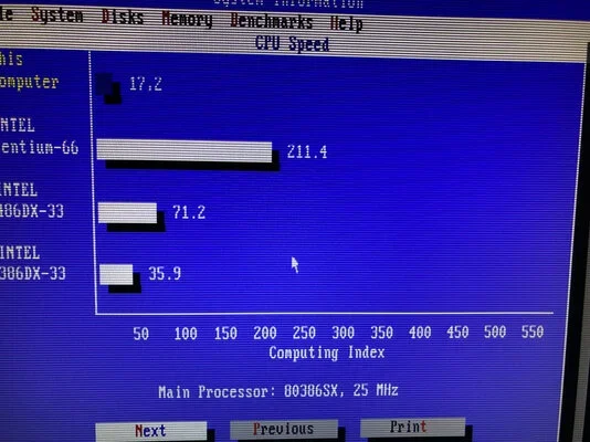

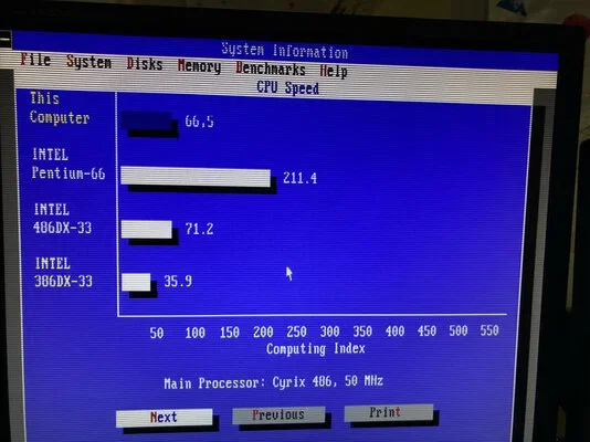

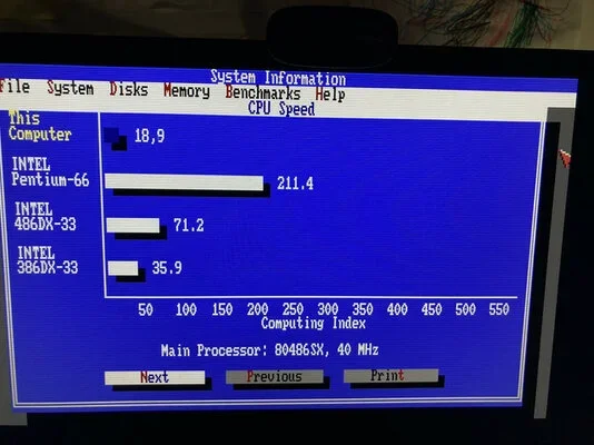

"Finally, for reference here are some benchmark results of Norton Sysinfo:
* the GG386 AMD 386sx @25MHz
* The Commodore A2386 with Intel 386sx @ 25MHz - faster than GG386
* The Commodre A2386 with Cyrix 486SRX2@50 MHz - almost a 486 DX33
* PCTask with 68060@50 MHz pretending to be a 486sx cpu, roughly equivalent to a 386sx@25 (but the video emulation is slow even with a lot of RAM and Z3 RTG board so it is nowhere as smooth as any 386 bridgboard)

I use the bridgeboards (the upgraded Commodore A2386 being my favorite and stay inside my main A4000) only with dedicated VGA card, sound cards and so forth. Those tests were performed with the STB Nitro 2 MB ISA which is one of the best card around. Pictures were taken for the bridgeboards from the VGA input of my monitor, with a scanline generator connected in between the VGA card and the VGA input, whereas PCTask screenshot is taken from the HDMI input of the same monitor out of the ZZ9000 with no scanlines.
Norton Sysinfo uses only a few colors anyway and run in 80 columns mode. For each PCTask resolution, i use a matching or closest resolution from the ZZ9000 P96 in 8 bit, which is the minimum color depth i can set and is fine for PCTask from 2 to 256 colors. There is not better to expect from AGA rather than Z3 RTG. In my experience of video emulation for PCTask or Shapeshifter in 256 colors or less, AGA outperforms any Z2 RTG card, but is of course beaten by Z3 bandwitch.
Norton Sysinfo always gives the same result with the BB once set up for good. PCTask can fluctuate a bit its score around 0,1 or 0,2.

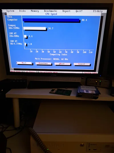

Here is Sysinfo result on my A4000 from my BB card, MHz is messed up though, 486 CPU is running at 60 MHz.
BTW: A2386SX got a port for a small box that automatically switch monitor between VGA card or Amiga, if that was your issue with BB.

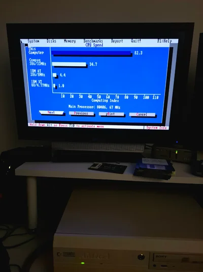

Here you go! Totally messed up result. Even the previous posted picture of my A2386SX 486 results is misleading, as the small Sysinfo code probably loops in the 8KB CPU cache, and not from the bottle neck 16 bit system bus on the board. But way more realistic than PCTask results.
Its more like the non-related Sysinfo-program on Amiga when testing an A3640 with 060 adapter. It shows the same speed as a real accelerator with a fast system bus and fast memory access, in reality its about 2/3 as fast do to all the wait states.

Ha ha ha! Thanks! :-)
This is actually informative, as it is funny. I think we can maybe make sense of something here between these two tests.
We have a nice civilized/standard 68060 50Mhz showing 18.9 CPU score on PC-Task and we have your supercharged 68060 at 100Mhz giving us 82.3 PC-Task score.
We have your A2286AT video showing 4.4 CPU score and @Xanxi's A2386SX showing 18.9 CPU score.
Both of these scores are about 4.3x difference, which is an interesting coincidence.
68060 50Mhz is just about 40 Mips and 68060 100Mhz is just about 80 Mips right? Is that 2x or 4x? :-) How is that viewed in terms of CPU performance in real execution time of a task, approximately?
Wonder what PC-Task tweaked to get the results, and if another test can be used for verification. Wasn't this a period in even PC history where these testing apps were gamed and questioned and PC magazines used a bunch of tests to get a more truthful reading?
Meanwhile, this is certainly a reason to get a 68060 going at 100Mhz in your Amiga...you get a 486SX66 free with that upgrade! :-)

Here is my A2386SX (486) Sysinfo:

You don't get near a 486SX in PCTask, as Ive explained.
You didn't comment my A2386SX Sysinfo result, which are way more realistic.
