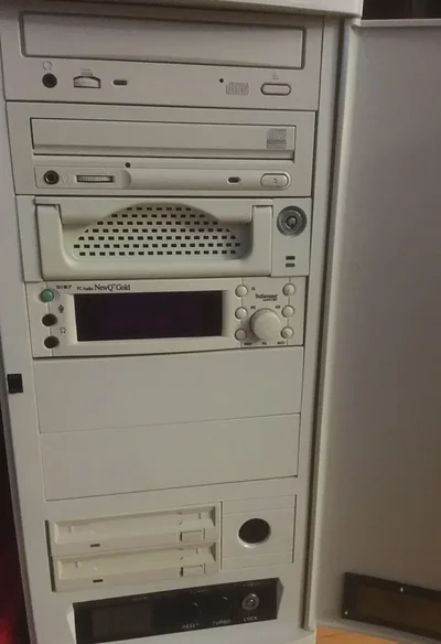

Compz tower, just like the Micronik, loads of space, easily fits a Blizzard 2060
@Buzzfuzz - am I seeing empty bays? I mean...mega-props for the sweet Syquest drive, but you need to fill this thing up Buzzfuzz. For the good of humanity...more drives please and urgently! :-)
Well that is someone else's job now, I sold it years ago, currently only have a desktop 2500/30 and about 9 A1200's and 5 A500's.
