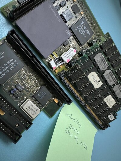

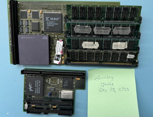

I've decided to sell my Cyberstorm MK2.
To the best of my knowledge, the card is in fully working condition and has just been tested again for multiple hours using an A4000T w/ OS 3.2.1.
It comes with 128MB 60ns RAM modules and is equipped with a Rev 6 CPU, thus running very cool at the spec'ed 50MHz.
Based on the paper on top of the oscillator it has never been overclocked, definitely not since I've owned it given its rarity and value.
Also included is a box in rather poor condition and non-matching serial number, which I've purchased separately a few years ago.
Asking price: EUR 1300 1200 1100

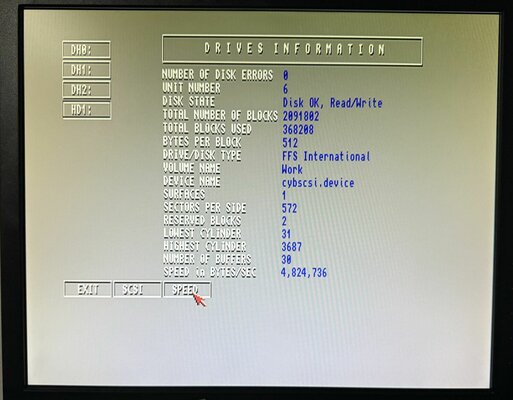

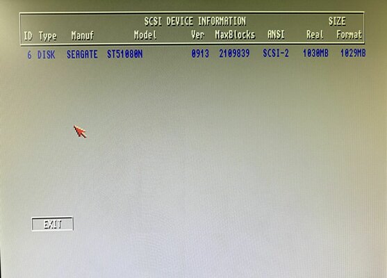

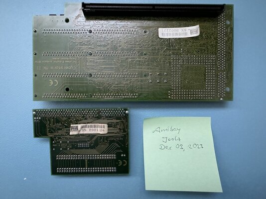

Also for sale is the matching CyberSCSI module. As shown in the pictures, I've successfully tested it using a SCSI harddrive.
Asking price: EUR 175 150 or nearest offer

I don’t know fore sure - as said I’ve bought it exactly in that manner and was able to successfully test an attached hard drive by copying data from it to a usb stick. Other than that, I’ve never used the CyberSCSI module myself despite having it, I threw out SCSI of all my machines a long time ago.

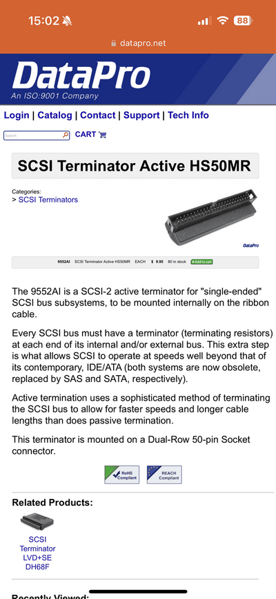

Yes. That's do the trick. You connect it to one of the connectors of CyberSCSI.

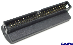

The external module can be replace by something like this connected to the internal scsi cable :
I did it on my warpengine scsi... I just cut the metal slot on both side and drilled 2 holes so that all fit well on the back of the 4000D....

And what is your transfer speed (read/write) with not terminated SCSI bus?
I bet it's 2,5MB/s just like IDE?
Hi Picard. Don't want to hijack this thread, so just very short: Yeah, your assumption is about right: Similar to IDE. So correct termination might make it faster. I can test and post the results in a separate thread, if anyone is interested. If it does actually make the setup faster, however, quite cheap termination can be added, even without the external connector - as mentioned by others in this thread. So the missing connector is not a crucial part, imho, but relatively easy to replace.
