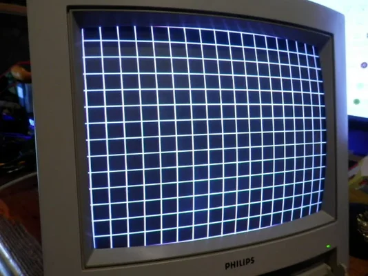

its alive :LOL:
ive replaced the offending parts,and done a setup its passed
pictures for you all to look at,manditory cross hatch and colour bars picture is quite good,dont let my camera lie to you :)

i think i should ilaborate a bit more,lets call it an edutalkypoint,haha
the hot that was installed has a metal back plate,internally the transistor's collector is connected directly to the back plate,with me?
the heatsink,is connected to ground just like the emittor of the transistor,so dead short from collector to emitor
these are fitted in a mk1 with a sil pad,a insulation sheet,but works in pretty much the exact same way,and the heatsink its fitted to is grounded
in the mark 2 they fitted a transistor that was in fully incased insulated package,no metal back plate,such as a BU508AF or 2SD1577
service manual,suggests a BU508AF,BUT the schematics says BU508A
what i think happened ,is he read the schematics and bought the wrong one with out thinking,right? because the schematics say so,understandable...
if he had fitted a sil pad between the heatsnk and the transistor,this would of worked
this could of ended up with a dead flyback and or faulty supply if left long enough,but since i very rarely see a faulty supply on these from shorted hot's ,but i can say i have seen the hot take out the lopt primary winding,with me?
what im surprised about is i was told the led came on when its turned on,i never tried it when it came here,and i dont normally turn crt's on without checking for shorts,when im told its dead,or someone tried a self repair and it dont work after,I.E : has no rastor
what would normally happen is the 128 volt rail gets dumped to ground witha faulty hot,so the supply laods down so much the led dont come on same with a shorted winding on the lopt,it loads the supply down too much because there is no ringing(dont ask me what that means itll take ages to explain,yes i have been asked a few times)and the flyback transformer,relies on a ringing effect to work properly on the primary side,like a switchmode supply
