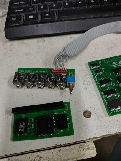

Prelude ZII V3
this card is small then the half zorro card that i have made , even the mpeg-it are smaller ( prelude are 14,4CM by 7,8CM / Mpeg-it 5,9CM by 3,4CM )
i have put the aux2 from the card to the backplate and now is it posable the switch the aux1 output to the line output , when you use the mpeg-it you don't need the unplug the speaker plug , you turn the switch and the aux1 goes to the line out for playing the mp3 , when you switch back you can play modules or amiga audio true the line out , and you can put the amiga out into the aux2 on the backplate to passtrue the amiga audio
and the mpeg-it wil be soldering on the connector to same more space between order zorro card's
i'm busy to build 6 prelude card's , but must wait that i get the bacplate pcb's and the mpeg-it pcb's here next week
but you can preorder the set , the price inc. shipping will be 165,- euro NOW BECAUSE OF THE FIX 155,- EURO INCL. SHIPPING

Sounds great, i have a mediator in my A4000T and it blocks for full lenght Zorro cards....
but i have 2 questions...
1:
You write it saves space then MpegIT is soldered on the board, but does it block the next Z2 slot ?
2:
Why is the switch needed ? I have the original Prelude with MPegIT and run AmigaAudio to the input and AmigaAudio and Prelude is Mixed to the same output. so i dont switch cables..
Regards
Peter

hi , that i soldering the mpeg-it on the connector there are more space for the next zorro card , normale there is space but not alot for the next zorro card , and now there is more space for sure that nothing can happend with the next zorro
and the switch are for some people that use not the mixer , i don't even use the mixer , but it is on the backplate and u can use it but u can also use the mixer
