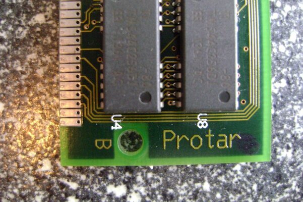

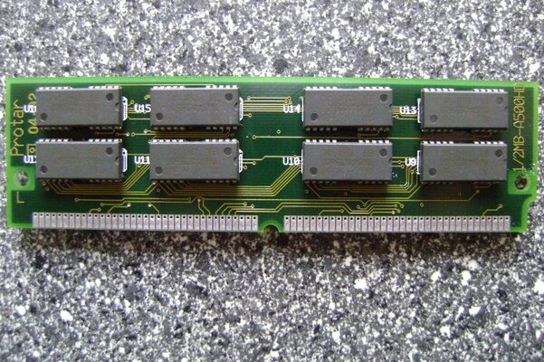

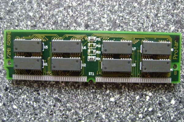

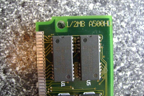

I've found an original Protar 2MB memory SIMM (see pics), that belonged to the Protar SCSI device that I had bought some years ago. Because it was only 2MB, I've replaced it with an 8MB module. I've sold the ProtarHD some time ago, so I don't know exactly what type of memory the 8MB module was anymore.

Now isn't that something!
I would be curious as to the pinout..... before one tested it you should check the ground and power plane pinouts on the edge connector (so one didn't fry it when plugging it it...
you could do this with a multi meter and this chart from pinouts RU
Actually this could also be done on the Protar socket as well to ensure that ground and power line up where they should...
I would like to buy this one, MC680X0. PM sent
Zetr0, I guess that the pinout is similar. At least what I can see in the picture is that the presence detect signals are in the same place.

1/2mega in photo are half mega not 2 mega, i understand, please confirm if in photo are another simm
It's 2MB. I've tested it some time ago with a ProtarHD device.
These memory sticks where pre-printed with 1/2MB, because
some memory banks actually had 1MB and others had 2MB on them.
