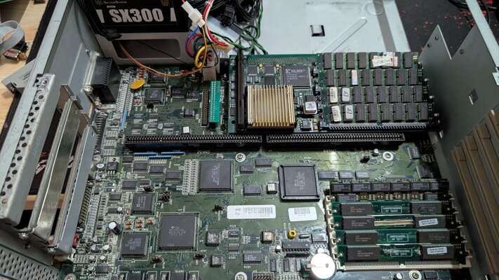

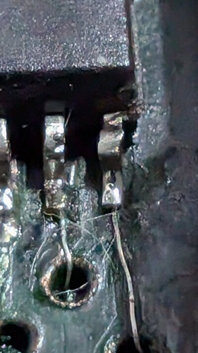

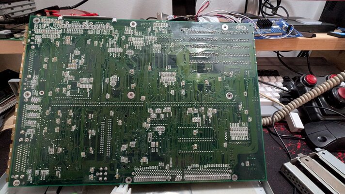

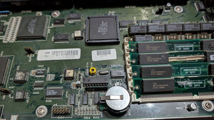

I am thinking of sending my a4000 D motherboard to a pro technician to transfer all chips to a ReAmiga 4000 board. I am doing this because I am tired of trying to find what is wrong with the board. This is going to cost me a good amount of money. Do you think it's a good solution or should I send the original board to someone who can fix it for a fee?

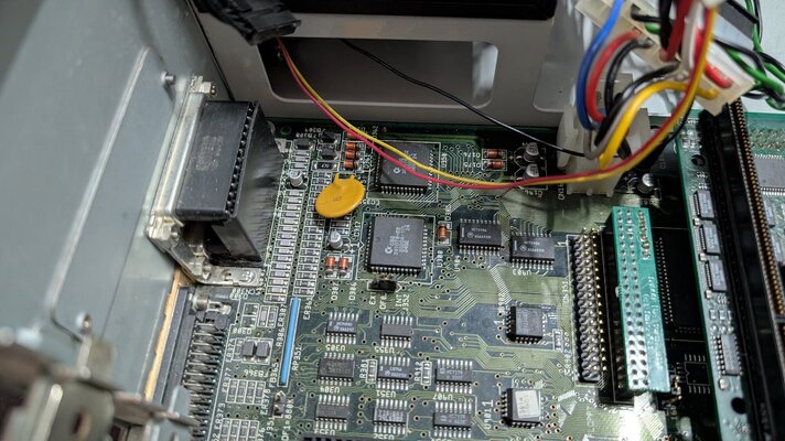

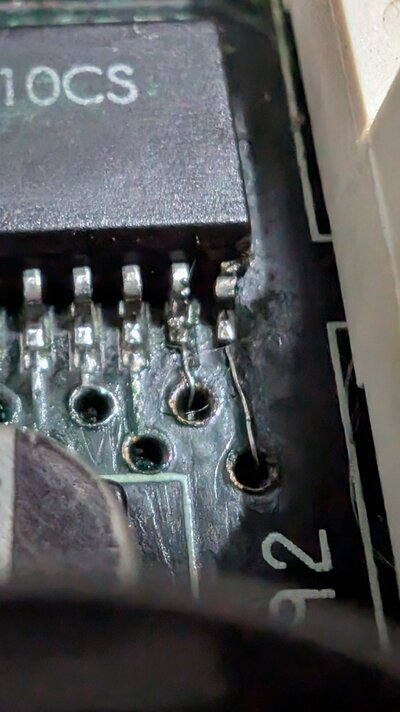

From a restoration point of view, if the board is battery damaged then it might be for the best to transfer all the bits to a new board.
You could also check sold listings new vs original boards to gauge a value.

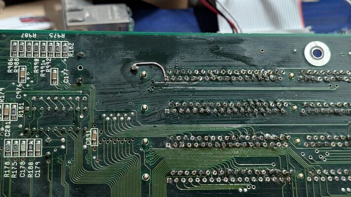

For me it would depend on what's wrong with it, if there's no damage to the board, I.e battery/capacitor leakage, etc then I'd opt to get it repaired first. But if the board has suffered corrosion damage, depending on how bad a transplant of the custom chips to a new ReAmiga would be advantageous.

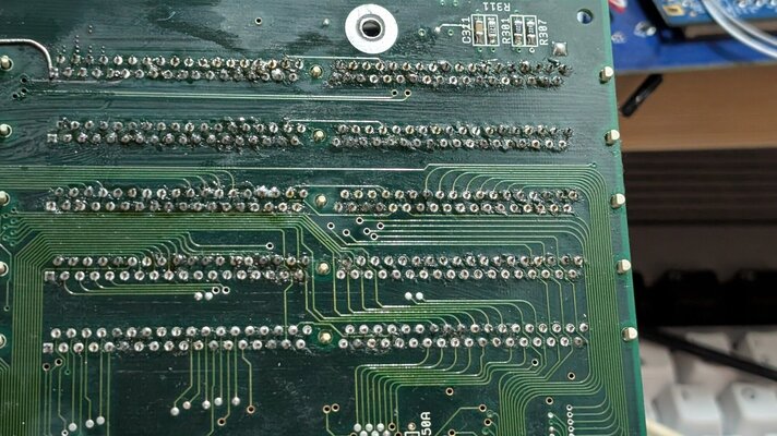

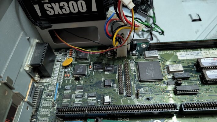

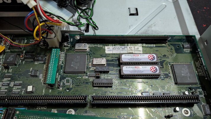

The board has no corrosion damage or other leakage, I am suspecting that I need to replace or resolder the ROM sockets, or the CPU socket. Anyway, I think It's something that an experienced technician could fix, that's why I am not sure about the ReAmiga approach. I would do it if there are other advantages..
Just my opinion but if it can be saved and kept original that's a good thing. Good original A4000s are getting harder to come by

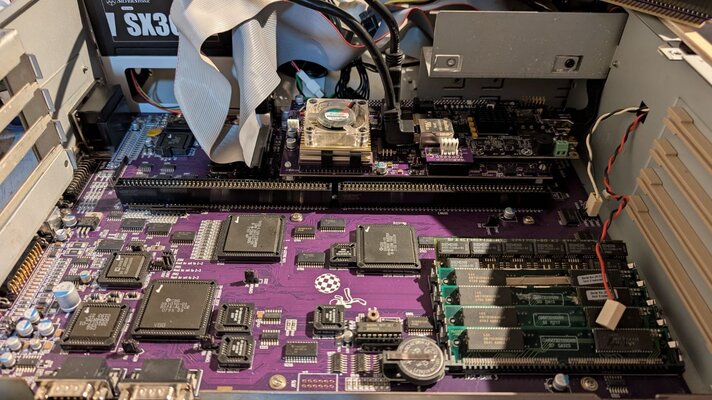

Depends on what you want and the price you are willing to pay. All of my boards are brand new and the only thing original are the custom chips. Many old systems keep having problems even after repairs as they are 30 years old already and I am pretty sure Commodore never though they would be used more than maybe 5-10 years and then binned. We all know that Commodore were cheapskates.

My Honest Opinion. Try the repair option first. Although I have a board that was recapped a while ago which had battery damage and now has started to fail on CIA plus RGB all of a sudden.

As for re-Amiga. You can now get something called the Saft6luck Rev 2.2 (Soon a 2.4) upgraded ACILL board. I have one of these. It boasts a few enhancements such as now accommodating 112MB Mainboard FastRAM from a 128MB or 2x64MB Simms etc.

What problems do you have with the board?
Ok, probably bad rom sockets, which is an easy repair for a skilled technician. It's better to have the board repaired than to 'reamiga' it.

Hi guys, having been in the same situation as some of you, I had to have my board replaced using an Acil replacement, the board has been in my machine from New but had battery damage which did not at the time of the original recap and Ram socket replacement seem to bad, the machine ran without problems until late last year when it became very unstable. The replacement board is now fitted with the original chipset and my old ram. Now it is not an original machine but just like many Amiga's back in the day I have done a replacement motherboard. Ok to make it clearer by that I mean if you buy a classic A1200 or a Classic PC it would not be surprising to find that the motherboard had been changed in the past one of my first field repairs for PCWorld turned out to be an Amiga 1200, this machine had to have a motherboard replaced onsite, So is that still and Original machine?
