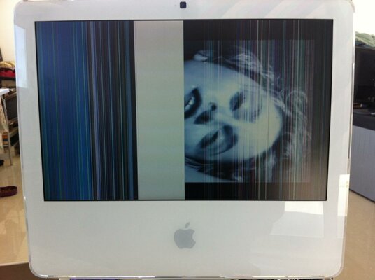

I might be buying this older iMac and just wanted to ask some questions.
It is a 17" Intel Core Duo (Not Core 2) 1.8G3hz and comes with 2GB RAM, Snow Leopard, 160GB HD, Superdrive and mouse and keyboard.
It works perfectly but the screen is damaged as in only about 30% of it works. It does have a VGA out etc and is currently used with an external monitor.
I offered the guy a price which is around the price of 2 new PS3 games rounded off to the nearest 100 hint hint and he accepted. Collection is local, so i have no P&P etc.
Is it worth-it ? And does anyone know of a good, reliable site where i can get a replacement display / lcd for it ?

This is the problem.. Look at pic. The GPU is fine as an external monitor works.
Well first off , I have bought these in the past and looked in to this.
The LCD is fault and was a manufacturing fault on the 17 inch iMac - very common fault.
You can replace the panel but..
The are (almost) unique to Apples iMac, you can find similar models in other monitors but not exactly. The model number for the Mac screen is important. Second hand working screen appear but carry a hefty price tag.

I bought this display which according to the UniMac website is compatible:
http://www.ebay.co.uk/itm/130702414...X:IT&_trksid=p3984.m1497.l2649#ht_1372wt_1180
It was cheap and is the same resolution 1440x900 as the original 17 inch LCD of the iMac.
Next up, when i have some money i'll buy the unimac adapter. Checked out ifixit and it looks pretty easy to open the mac and replace the display.
---------- Post added at 09:59 ---------- Previous post was at 08:32 ----------
Just for future research (for when i can afford the unimac) i followed the guide on ifixit and opened the imac and did all the steps up to the very last one of unscrewing the mountings of the lcd panel (only because i lack a long/thin torx screw driver)
It's a breeze and hopefully i'll probby manage to replace the display in no more than 1 hour :)
