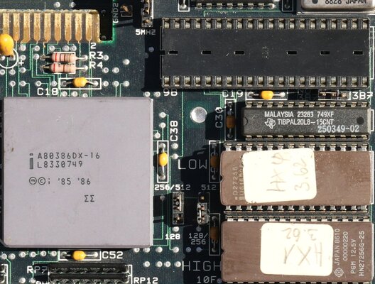

2.) Does it require any additional cable? The DIL socket next to the ROMs/CPU looks suspicious (see attached picture)...

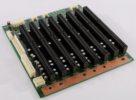

As far as I know these SBC cards are intended to be plugged into dumb power only SBC boards like the one below. My understanding is that if you plug it into something like a 286 ISA the 286 Motherboard and this SBC motherboards will be fighting over control of the ISA bus and who know what type of drama comes out of that battle.
On the other hand, inside an Amiga 2000 for example where is nothing in control of the ISA yet, this type of SBC card is perfect. Your A2000 is just begging to have this in there! Upgrade the 2 8bit slots to 16 bit, drop in some VGA graphics and a sound card and DOS game or Win 3.1 your brains off for a fraction of a A2386SX...and with a DX CPU too.
