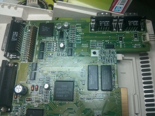

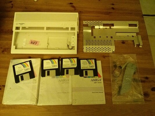

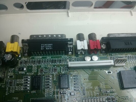

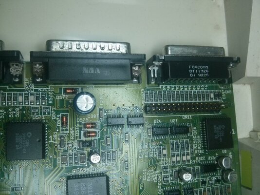

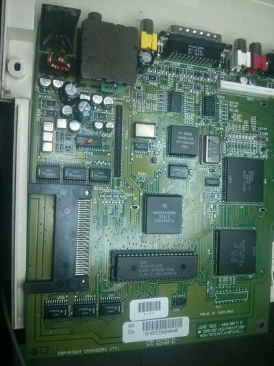

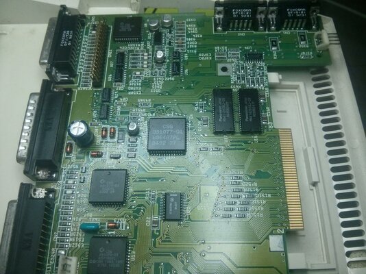

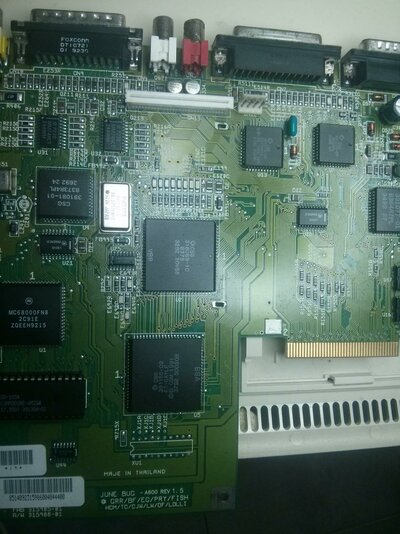

State of my A600:
IMG_20141215_000221.jpg IMG_20141215_000230.jpg IMG_20141215_000238.jpg IMG_20141215_000243.jpg IMG_20141215_000258.jpg IMG_20141215_000309.jpg IMG_20141215_000312.jpg
I already send the metal shield to "repair" I don't have a picture to show how bad it was, but you can see what she looking now:
I'll add more pics over the time I progress.

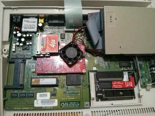

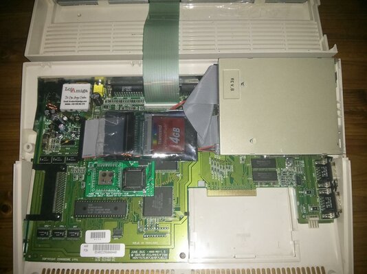

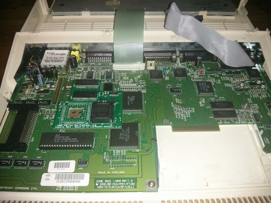

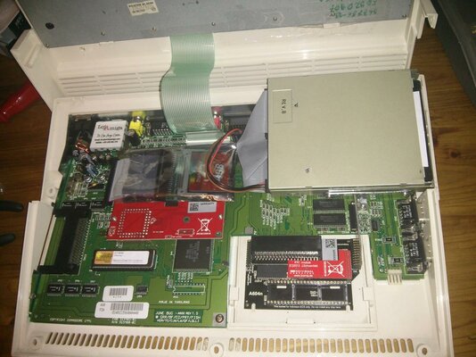

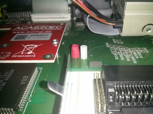

There he is with CF 4gb and Kipper2k 4mb ram:
IMG_20150318_152915.jpg IMG_20150318_152921.jpg IMG_20150318_152936.jpg IMG_20150318_153543.jpg

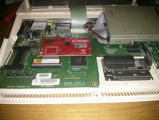

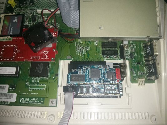

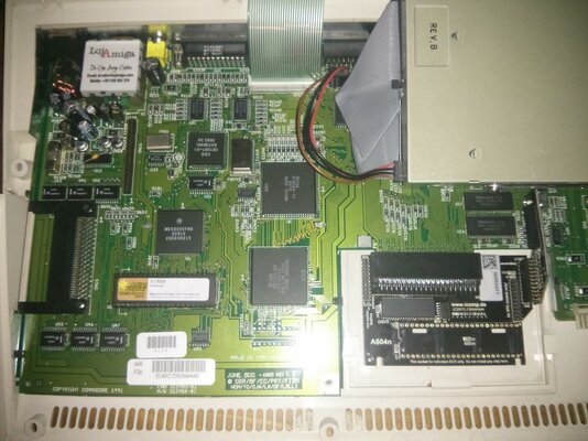

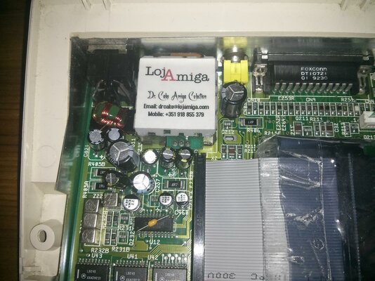

Now I add this pearls :
- ACA 620 incl. CPU 68EC020 and 10.8+5 MB RAM Rev.2
- Kickstart ROM 3.1 Amiga 500/600/2000
- Indivision ECS (still waiting from AmigaStore.eu :()
- A604n - RTC (Real Time Clock module)
IMG_20150318_152856.jpg IMG_20150318_155257.jpg IMG_20150318_160201.jpg IMG_20150318_160427.jpg IMG_20150318_161445.jpg

small update, just receive the new Indivision ECS (green pcb) and upgrad to 8GB CF
Now I have problems when boot my A600 (ClassicWB ADV v28 ), had to reinstall Workbench.
But I don't know how to take correct profit of Indivision ECS, I mean it work strait out of the box, but I want to use with 640x480 or 800x600 resolution with 8 colors, but it seems strange with CWB v28.
