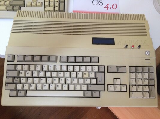

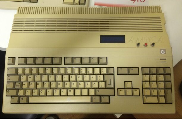

Another good day for retro bright using the vanish crystal white - this time i did all the keys from one of my a500's except the one i didn't realise had rolled off the Desk and under my filing cabinet! Doh!
Before:
After:
I just need to do the case now.
Ps amazingly it makes the entire case look less yellow'd.
Retr0bright Support Thread
Adjust the white balance using the white table top as reference.
I meant in real life.
Ps yeah the lighting conditions weren't quite the same. If you compare the ü key to the other's you get a good sense of the color change.
Btw, the second pic is the most accurate in terms of color accuracy.
Ok after some tweaking i think this is a bit more accurate.
Problem is the lighting conditions are quite different.
