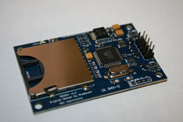

The SD2IEC is a hardware mass storage device using an SD/MMC card and interfacing with the IEC bus. The SD2IEC is an emulation/replacement of a Commodore-1541 disk drive for a C64 and 128.
The hardware is a small credit card sized board with an sd reader
Slot and 5 wires soldered on it, which need either connecting to
The c64 serial port with a plug or soldering directly to the c64 / 128 motherboard.
(i have diagrams if anyone needs them)

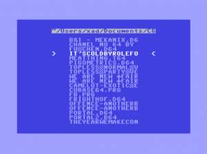

It's pretty simple to use, copy your .d64 and run them as you would a real c64 disk drive program or use a simple file manager. I personally use the file manager, it's quick and easy to use, highlight the program name and press fire on the joystick- easy.

A word of warning with the NKC board pictured: their quality control is rubbish and their after sales just as reliable. A few of those boards (including mine) were delivered non working to Lemon64 users. They don't offer to replace faulty boards!
Better go with Jim Brain's ones that Heather mentioned. They seem to work most of the time and you can actually get hold of Jim to help if they don't!

I confirm that there are a lot of versions out there, if you are not into soldering one yourself, I can warmly recommend the one by jim brain.
Just make sure, if you don't want to put it inside your c64/128, to buy the deluxe daughtercard version.
