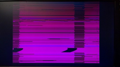

As for progress - so I played around as much as I could. I chose RGBHV. I pressed the Down/Auto button for over 5 seconds - it appeared to reset; however, no change.
I then scrolled through the menu selecting the appropriate display resolutions, and these images are the most I could come up with. 3 amigas, 3 seemingly different results.
http://www.youtube.com/watch?v=zZmEwXujRdg (no adapter)
http://www.youtube.com/watch?v=481SVXGFdkU (5V 2A adapter)

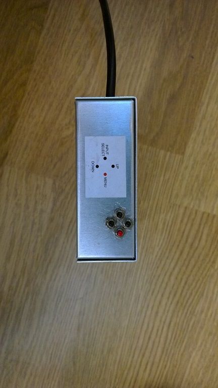

I have the newer version and I got the images below, don't know if this helps?
Virtually identical controls as the 8220. I'm thinking it may be either the cable or the hardware itself that's not working at this point. Based on the images and video I've provided - does that seem a reasonable assessment if I've tried all display resolutions / input options / with and without adapters (5V 2A & 5V 3A) / on 3 different Amigas?
