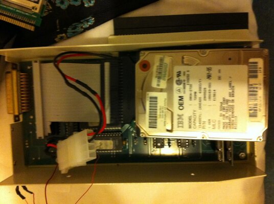

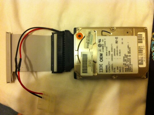

I've just taken delivery of an SCSI to IDE hard drive setup for an A500..

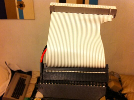

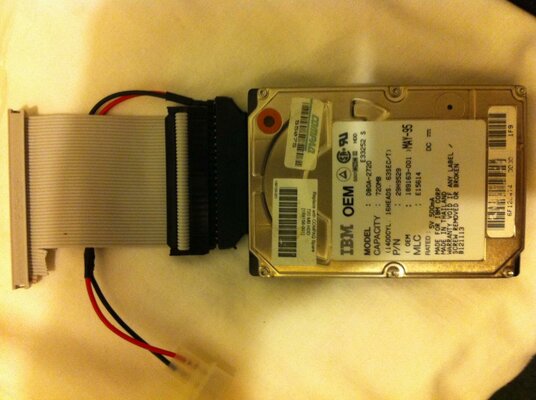

but the supposed SCSI to IDE adaptor is shown in the pic? The conversion seems to consist of cutting a 50pin scsi cut to IDE dimensions and fitting a 3.5 inch IDE plug on the end!
Then a 2.5 to 3.5 ide adaptor is fitted....
result
The hard drive is buggered and the A500 side car crashes constantly.
with the hard drive connected or not. my scsi drive isn't recognised either.
I must admit i didn't event notice it was a plain old 3.5 to 2.5 inch adaptor until closer inspection.
I've tried the IDE drive in windows and it isn't detected - dead i expect but it does spin up
my 1gb scsi drive isn't detected by the amiga in the this sidecar ...
and the sidecar locks up or gets guru error after 30 seconds or so - maybe poor connection - more investigation needed.

To good to be true my friend, people do not pay that amount of money for conversion prints:(
Sorry to dissapoint you, but if it were that easy, we'd all be doing it.
I fear someone has tricked you.. :(
trying to pull my p****ker i think the saying is.

Thats just aweful - I'm shocked anyone would sell that :thumbsdown:
and the ribbon isn't even cut straight :-(
i mean come on!

44 pin IDE genders do not work on 50 pin SCSI headers. The data lines are very different.
Pin 41 & 42 on the IDE is +5v & pin 42 on SCSI is ground. Not looking very good at all.
Well I have a suspicion that the controller is buggered. It locks up after a few seconds of use and does not find an scsi hard drive.
All I can do is try it some more and check the manual. There could be issues with accelerators or kickstart rom. So at the moment I have my fingers crossed that its not complete scrap.
The IDE hard drive that came with it is scrap , spins up but isn't found by my a 600 ( drive not installed, no hard drive found) or in windows - not detected at all.
More investigation needed.
