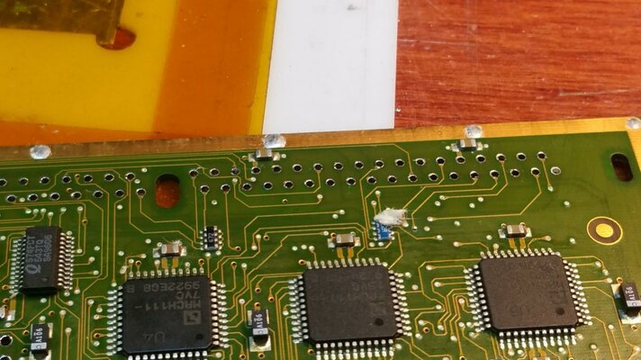

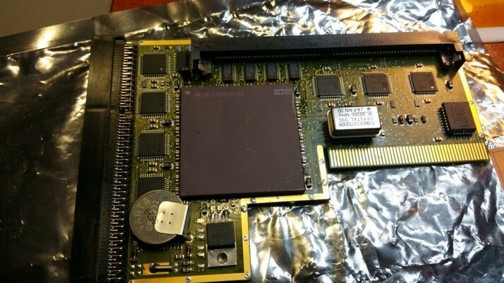

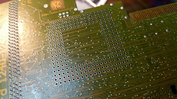

As previously discussed as part of other re-cap work, interested in DCE Blizzard 1240 Tower to 1260 Desktop upgrade, thanks.
Bester's Blizzard 1240 have been upgraded to 1260. MC68060RC50 CPU with 71E41J mask, the card is happily buzzing away at 80MHz with the CPU at 45C warm without cooling (of course at open testbench so inside house temperatures might require heat control). SIMM socket changed from angled to 90deg, so card will fit trapdoor closed. Oscillator on socket and RTC has been checked. Very clean card.
