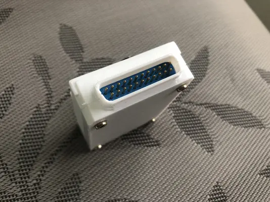

You can hook up a Gotek through the external DB23 disk drive port on the rear of the A500 using an adapter. Some people sell them on here or you can order one through PCBWay - search through RetroNinja's projects. Yes, the external Gotek will be DF1 but there are ways to boot from that device - just search on YouTube. IIRC you still have to open up the computer to change a jumper.

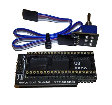

Here is an option I use which lets you switch between the gotek and original floppy drive as DF0:

You can buy gotek floppy emulators that plug directly into the disk drive port on the back of the Amiga. All that's required of you would be to plug in the device, and prepare a formatd FAT32 usb drive, then add adf images.
The only issue I see running an external gotek as opposed to an internal drive is that a lot of commercial game software are hardcoded to boot directly from the DF0 (internal drive), and not DF1 (external drive). And to get around that issues you would need to buy a floppy drive boot selector switch which then allows you to boot games from an external drive (y)

This is what i thought i had understood. You have to put a bridge between the mobo and a chip (the CIA one ?) and it doesn't seem unsurmountable. I watched a few videos on how to open an A500 and i was making a mountain out of a molehill. Thank you for confirming this. :)

And if i have myself set a FAT32 USB drive with FF.CFG in the root, all i have to do is either dump adf files in it or make subdirectories to be a bit less messy and i am all set. If i understand well, i don't even have to set interface= amiga or even shugart as shugart vs IBM PC is set via a jumper. I have the FF.CFG file from the archive found on github.
And i am all set ! I mount the DF0 selector in the Amiga, i bore a tiny hole in the plastic to allow the cable of the selector to go outside and i can boot either on the Gotek or the internal floppy drive.
