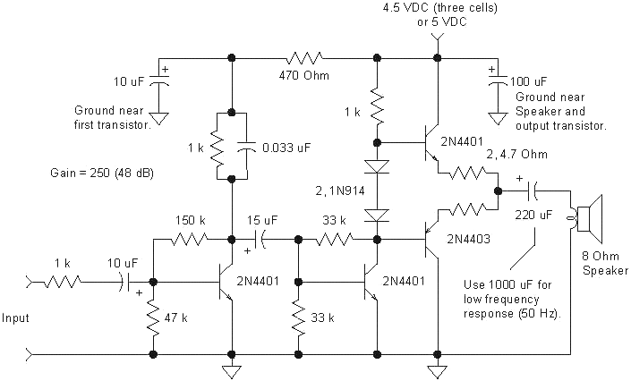

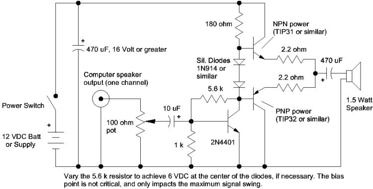

a small transistor amp shouldnt be to much work.
here is a simple enough one that should be able to be pretty small
This may be better suited though
http://www.techlib.com/electronics/audioamps.html

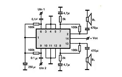

or an LM1877 plus some components..
Thanks for those :) I really need to study that sort of circuit - it annoys me that I have not the foggiest clue *how* that circuit works, or *why* the particular values of resistor and capacitor were chosen!
Yeah, I think that's more the kind of thing I had in mind - a very small footprint. Again, though, it annoys me that I have no clue *why* a 1877 rather than any of god knows how many other chips! :))
