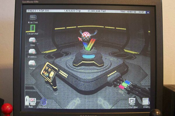

On the assumption that this didn't like Dell LCD monitors, I went out and snagged a used Samsung Syncmaster, brought it home and... exact same result. Awful workbench screen, shimmering around the mouse pointer, and vertical banding that messing with the h-size won't get rid of. Borrowed a mate's old 15" Microtek screen (not so much borrowed, he won't take it back, telling me I'm stuck with it now!!) and same result there too. So either I've got a dodgy unit, or I've got horribly unrealistic expectations from this, stemming from using top of the line macs for graphics work the past few years.
Tried snapping some photos of it, to show what was going on... images don't really do how bad it looks justice. Again, probably just me having overly high standards for this...

I dont get the bad vertical banding you see but I do get the slight ghosting around the mouse pointer.
Im about to add a sync stripper to mine and see if that improves things by cleaning-up the sync from the composite sync signal.

Somethings not right with your set up. If you look back to my pictures here on page 37 this thread, these were with a 40" samsung tv
https://www.amibay.com/showthread.php?t=20468&page=37
No vertical banding. Maybe there is a problem with vertical sync in your lead from amiga to gbs 8220?
The clarity of your pictures also seems poor hmmm
All the Samsung TV's I have tried get great pics with their built in SCART sockets. Doesnt yours have one? Is the Gonbes board+VGA better than the inbuilt SCART and a SCART cable from your Amiga? Can you tell the difference?
