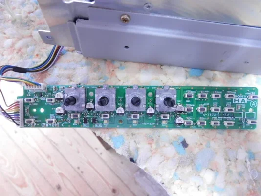

also,i noticed something i didnt notice before,the front right panel is damaged, some controls dont seem to do anything and it doesnt light up
this i will take apart in a bit for investigation

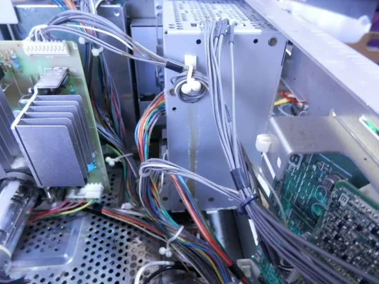

and i have spotted liquid spill in the case,i didnt see it when i was taking it apart
this hasnt moved at all,since removing the G board for inspection
Which controls on the front aren't working? Just checking as if you're using the same device to test it as before, the chroma and phase controls don't do anything on RGB (and the buttons won't light up either), this is expected behaviour as far as I am aware
contrast,and brightness and it didnt light up when manual is pressed is does now
the controls where really slack,ive taken it apart,and it was damaged,loose clips holding the pots together
ill have to find out why the deguass dont work now for some reason
see how ive closed the clips on the pots,they were opening up the contrast pot was falling apart,maybe it took a bang,i wouldnt know,but that would be my guess
second picture you can see the spill,i didnt notice it before,but i looked when i felt the cables were sticky,a drink? i dont know,but its right over the supply
but it doesn tseem to be in the supply
it doesnt matter now,i have to take it apart again,to find out why degauss dont work even though its connected and i can hear the relay,strange stuff

right,oh my god...phew,ive fixed the control panel faults and the degauss
degaus was,brace yourself buddy,it was drink spilt on the connector,ive cleaned it, it seems to work now
