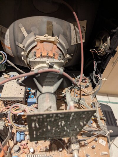

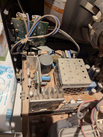

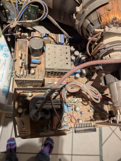

Hello,
First time poster here after scouring Google for UK CRT repairs.
Anyone able to offer repairs? I'm based in Telford but can travel to drop off/pick up.

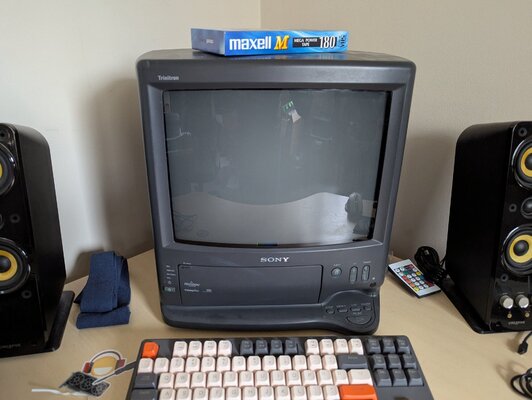

I have a loved Sony Trinitron KV-14V4U which I use quite often for playing my MISTER on.

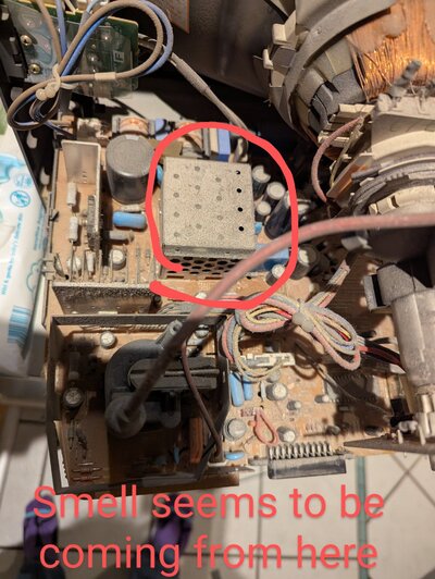

Unfortunately it died the other day, I left the room for a few minutes whilst it was on and when I returned there was no picture and a strong smell of burning plastic.
After letting it cool down for an hour I took the back off for a look. I couldn't see anything that looked burnt or any capacitors that had looked to have popped. Following the smell with my nose it smelt like the burning was coming from a transformer (circled on picture - may not be what I say it is 😊).
I tried to power it up again for science. There was a good sound like the TV normally makes when it is trying to start but no picture appeared and there was a bit of a fizzing noise before that stopped. I unplugged it again then in case I caused further damage.
To be fair its full of dust and the battery that retains the time and calibration settings has gone so its in need of a bit of TLC if anyone is up for it.

It sounds like it is the flyback transformer.

its lopt failure or if you like flyback is toast,i'll try to find one but its not looking hopeful
i'll post a picture,it litrally has a hole in it
part is unobtainium,so that makes the tv unrepairable
