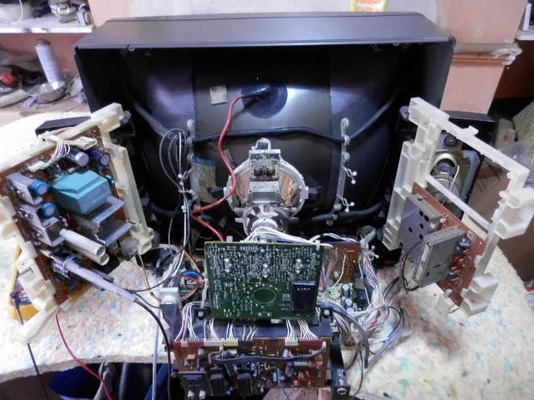

Hi,
I have a Sony Trinitron KV-21XRU that's in need of repair. It has been to the most local repair place I could find (Grendon Audio Visual) and I have been told that without a service manual there is nothing more he can do. It powers on, then straight off again(Red light, no picture). Apparently the "in - out" should be ok but some resistors, etc have burned beyond recognition.
Here is a quote from the email I received:
"The set has had liquid spilt into it at some time. This has caused failure & burning of some components in the line oscillator circuit."
I can't think of anytime it's got wet, so I blame our cats. I've owned the set for 6 years or so and it was the first in my collection so I really want to save it!
Any help or guidance would be much appreciated,
Cheers!
funilly enough i was looking for the service manual,and turned up nothing much
i could have a look at it,but i wont promise anything
you would have to send me a pm for my address for drop off
this was dropped off just now,we had a chat
i'll look at this a bit later,damage assessment etc inspection
ive done a brief-ish inspection,horizontal drive blew for some reason
i will go order a part or two,and see how this turns out
board will have to come out its pretty filthy,and have a clean
i have a feeling the parts for this have been lost in the post
so,to that effect in advance i ordered another from somewhere else,yesterday

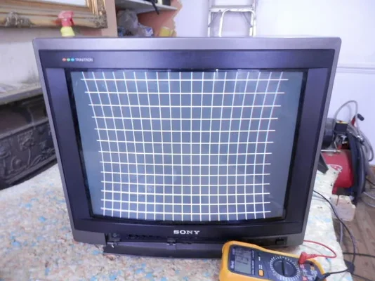

a bit of a update,this now turns on but still has a fault or faults i need to clear,and seem to be located on one board that no controls work on
so,itll be here a while ,while i work out what on earth is going on
at least it turns on now,right?
here is a couple of pictures,for you guys and girls to look at in the meantime

and before anyone asks,the controls on the board in question dont seem to do anything when they should,which is a hint

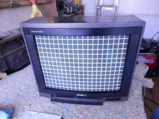

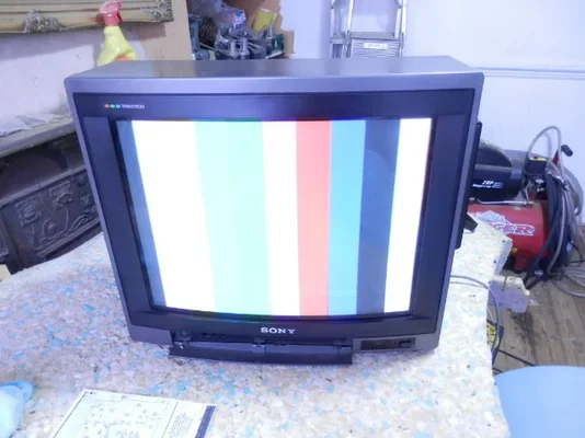

i knew i had a tda1082 knocking around somewhere,i just couldnt find it
anyway,this is now fully working,ill go let him know
a couple of pictures for the ladies and gents looking at this thread :)
pictures arnt great,the tube is facing my front window
i will put this back together tomorrow sometime
