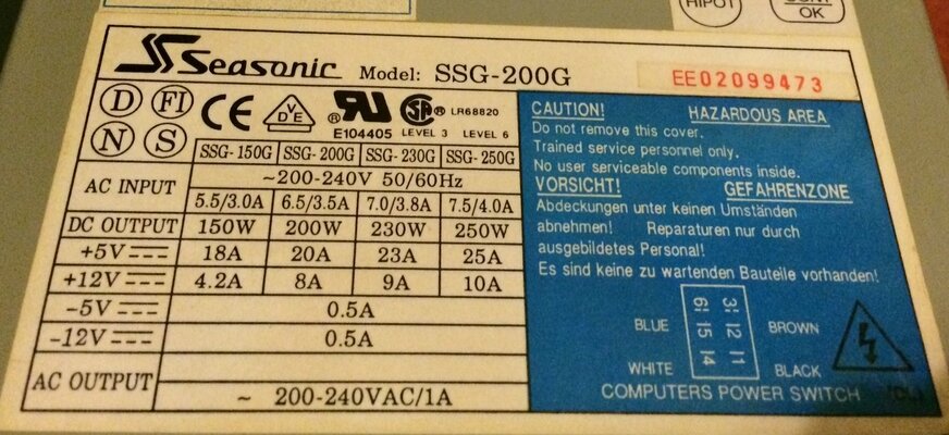

Here are the stickers on my current PSU
The PSU did not come with the Power Tower as I had to get a stronger one to power the 060. The last time I had a Mediator I could not get it to work and sold it, but at the time I didn't think about the power requirements so i'm hoping this is the problem. Next I disconnected the DVD drive, floppy drive and removed the Voodoo card. Best it can muster now is seeing the partitions if I boot from cold and go straight to the early startup menu and then I can boot with no startup and get to a dos prompt. If I try to boot normally it goes straight to the kickstart screen after a few seconds and then if I soft reset and check in the early startup menu nothing is there hd wise. If I connect the floppy drive it doesn't even see the CF drive attached to it from the first boot.
So now i've only got the main board, mediator, indi, lyra and cf attached and it still is incapable of booting properly. Disconnecting the other bits sort of made some progress so what does anyone think my next move should be? Should I be looking for a more powerful power supply? and if so will either of these fit the bill?
