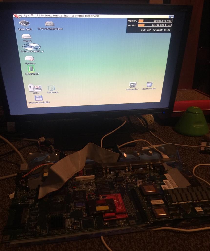

Heavily expanded A1200 now split
A1200 mobo received
tested it I was like why is it not working :double oh yeah no 020 cpu need a accelerator!!!
one question when does it start graphic glitching????
positive feedback left too
lol - yup, no CPU fitted!
With an Indivision AGA fitted, the glitches start from cold boot - with the cable attached to it it was pushing g the right side of Lisa up, but without it fitted, I've not had it do anything worrying after several hours. Most likely a dry joint so it'll need reflowing eventally if you're not going to put an Indivision on it :)
A1200 mobo received
it been on for a while now and still no glitches maybe it was that last magic push you give it :lol:
Ill try it with an indy to see what happens
Received parcel, very good shipping protection and packaging. First test booted up the BPPC but did not boot with B-Vision attached. I assume my PSU needs an update as it only provides 4A at 5V. Ordered a 12A/5V variant and will inject additional 5V to Floppy-Power-Port. Testing can start in two weeks from now as I'm busy until then, but assume everything will be fine. Great card, thanks for the deal.
Hi matey - it needs a biiiiggg PSU; Stachu recommended at least 8A on the 5V rail. On my board, I added wires for 5V, 12V and Ground from the underneath of the power supply connector to the rear of the floppy power connector - a common mod to improve power distribution. Injecting power into the floppy connector is another popular method though. Not all boards are equal! I know the 12V isn't necessary for this, but I had numerous 12V fans running from the floppy connector.
Unfortunately the BVision is showing loose pins and doesn't work :( . 160W PSU Installed and enough power is available.
Refunded for BVision - it was in working order when sent, but for whatever reason isn't anymore.
