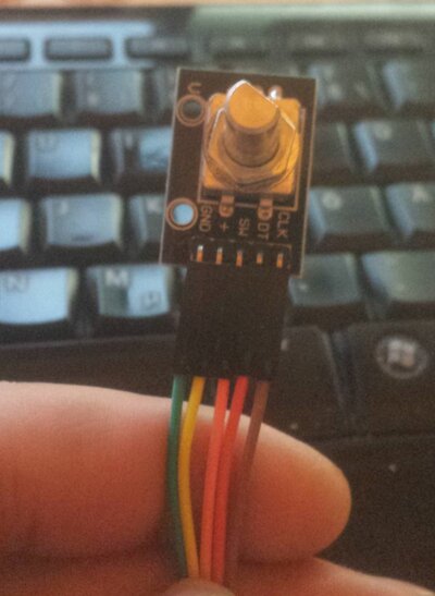

What nind of Encoder do you use? I´ve only KY-040
It has CLK, DT and SW

Okay glad it worked. Please test out the functions and if it's all good I will merge the code back into the master branch.

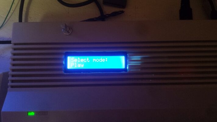

I´ve got 2 Problems.
First is that there is no back func. If you are in Options you cant go back. I think it will a option to press for a long time to go back.
The second could be my fault. I made a new board. But for now the Commodore finds no program after pressing play. The screen goes blue and the percentage go up till 100% without stopping.
In previous Version I made the Program found screens came after a few seconds and the motor grafic stops at the moment.
But this time nothing happens. I checked the Read line. It has physical connection. What I have not connected is the write line, cause is useless for me. Nothing to record.
The back function is ABORT and requires another button. The long press on SELECT is already used. As for the lack of loading, it does sound like no data.. Have you not inadvertently swapped your read/write lines?
-(e)
It´s running now. But I dont know why. I used a Connector for the port for testing and it was running. After that I used the soldered cable on the mainboard it was running.
