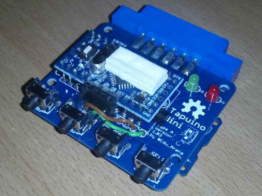

Unfortunately, you can not plug the Oled displays directly on the LCD socket, because the order is wrong. I just made a second socket next to it and wired directly:
Also the cheap China Pro mini boards can not be used directly, A4 and A5 lie with those in another position, I have connected by wire under the board.
Here i have added the positions of A4 and A5, simply solder some wire between them.
Used materials:
Tapuino Mini PCB 1.03
Arduino ProMini 5v (note the distribution of the pins).
4 SPST buttons.
2 Resistances of 1K.
2 Resistors of 220 ohms.
1 Resistance of 330 ohms.
1 4N25 Octocoupler.
2 2N2222 NPN Transistors.
2 LEDs (red and green, for example).
1 OLED I2C compatible (128x64 0.96")
1 Datassette connector.

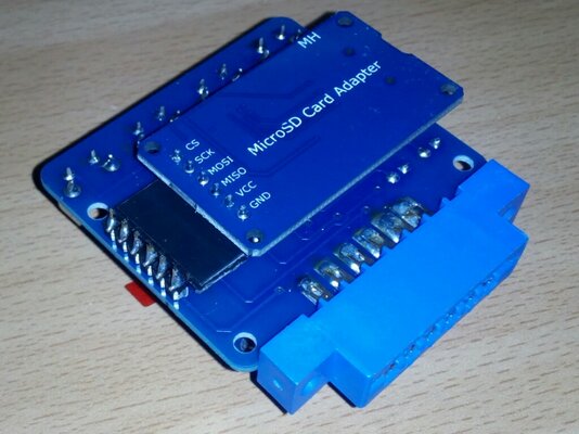

From the photos you can not see the SD card reader module.
It is soldered onto the back of the PCB?
