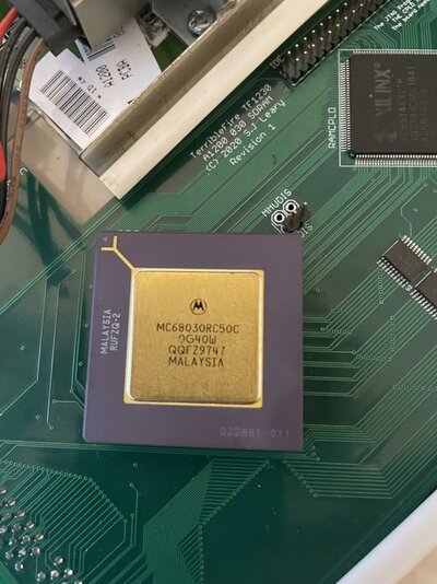

I have some strange issues with the TF1230 and I was wondering if anyone can help me on this.
I have it installed in a 1D4 board with timing fixes (I removed capacitors E123C,E125C). ROMs are 3.1 and I have an indivision MK2 fli-fi installed
The CPU installed on the TF1230 is a ceremic one @ 50 MHz. I run whichamiga and this one appears to be a genuine one.
The problem I have is a weird one. If I connect a CF card in the amiga native IDE connector the 1200 never boots with the TF1230 (blank screen, responds to CTRl + A+A).
If i remove the "enable 030" jumper from the TF1230 the amiga boots fine (logo and then loads a disk if it inserted) with no mem and 030
If I install the "enable 030" jumper again and remove CF cards the amiga waits for 30 sec give or take (IDE Check for a HDD) and then boots
If I run sysinfo from a floppy I can see the accelerator is recognized as a 030@51.80MHz with 64MB of memory
I have tried two different PSUs (one 1200 and one 500 4.5A heavy duty)
I have tried two different CF cards (transcend 4GB and 8 GB)
I have tried two different IDE2CF adapters (one angled from kipper2k and one el-cheapo chinese) all with the same results.
Both CF cards were installed in the same 1200 with a blizzard 1230 MKIV working fine (classicWB)
Do I need to do something special with the TF1230 so that the native IDE will work? I am not talking about the TF1230 onboard IDE as for this one I know a special ROM must be made.
Do I have to install something?
