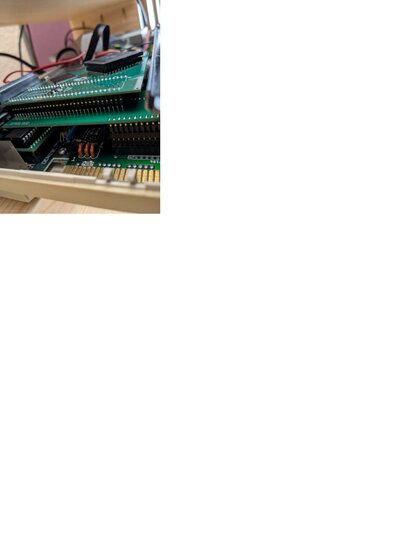

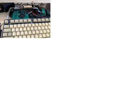

HI Guys after an eventful few Months I have finally managed to get my A500 not the Plus to work with all the upgrades I wanted.
TF536
Mega Chip
HDMI PI
its amazing the HDMI PI looks great I have the ECS INDI V2 and the HDMI Pi does a great job.
Now with the straight 68k relocator it goes over the Denise and the Mega chip is left alone the Denise HDMI is one I got from a great fellow on FB best part is the HDMI PI adaptor is powered as well so no under volting of the PI.
