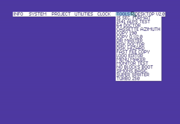

I have 12 assembled and tested The Final Cartridge III+ carts for sale (blue PCB).
Price is 30 Euro, registered worldwide shipping included.
I can assist with preparing a ROM with a custom list of programs/games that are available under the TOOLS menu.

I am interested with custom Rom. But what differs from the original to this one?
This one has 4 times bigger ROM (256kB instead of 64kB). SAM and EDK modified original FC3 firmware to make use of the additional memory, they added TOOLS menu filled with 17 utility programs.

Is it just these 17 utils or is there more to select from?
You can put any one-file program inside this menu. However, total size of the files should be below 192kB and maximum file count is 17. Step by step tutorial is here: www.siemappelman.nl/download/FCIII-Manual.pdf
It's not that easy to follow procedure described in the tutorial, so I'm offering help with preparing custom TOOLS menu programs.
