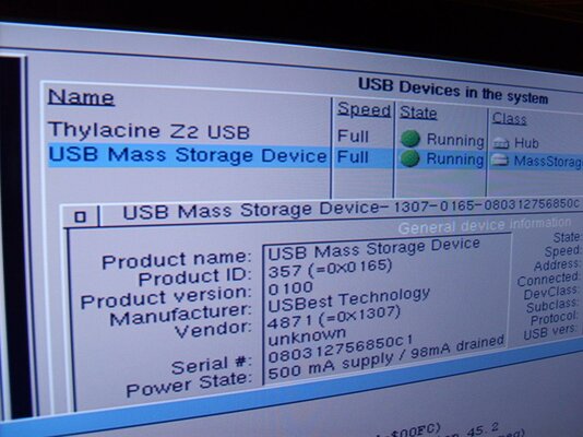

Thanks mate, Trident have many options, have you tried to 'play' with it?
If you use a keyboard, you can redefine all keys :)
Please set as default for massstorage.class max transfer to 64kb and save configuration. In this way all pen drive, sd/mmc adapter and external hard drive will work very reliable.
If you intend to use an external HUB, please choose an external powered type.

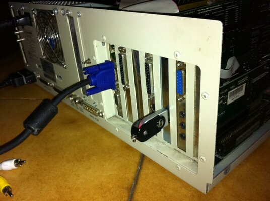

Hi mate, I have tried in my A2000 rev6.2 and works like a charm :)
See yourself:

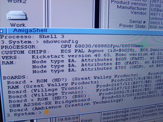

I think you have a software problem and/or hardware conflict, but my A2000 is almost full as I have:
GVP IMPACT3001 030@50 882@50 16Mb
Oktagon2008 w/ HD9.1Gb
PicassoII+
A2386 with Cyrix CPU upgrade (CX486SRX2 @ 50) + zip2simm adapter 8Mb
Thylacine USB
SVGA ET4000 1Mb
Sound Blaster compatible
OS3.9
2x29F002 instead EPROM for kick3.1
Please check! It MUST work.

Hmmm, should work then.
I was concerned about my 030 but seeing you also got a GVP 3001 that is not the problem.
The only cards in there are:
GVP 3001/8bm
Macrosystems de-interlace card
GVP HC8-II
A2000 Rev 6.2 (OCS denise)
ClassicWB (fresh install)
Fiddling around with the settings did not make a (positive) difference :(
I might try a catweasel/buddah card instead of the GVP to see if it is interfering with it.
