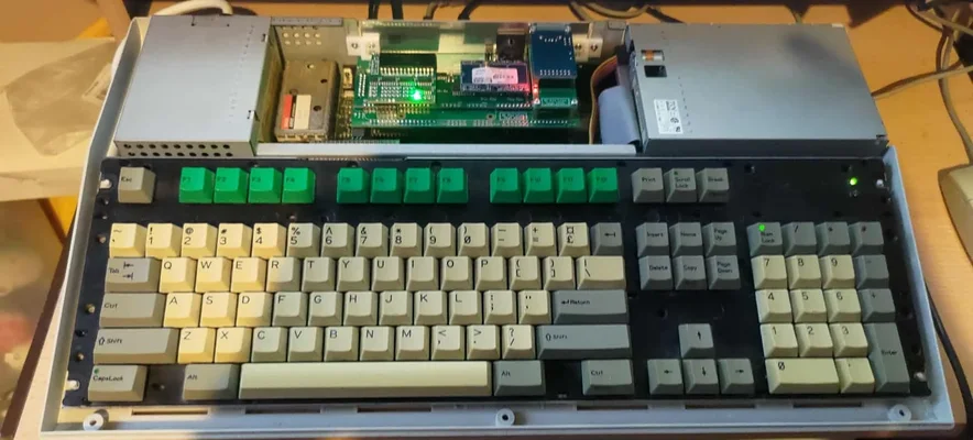

Howdy Retro Users
Some of you already know I recently acquired an Acorn A3010.
Sadly, it was a little poorly, and upon opening it up, I found the dreaded battery damage!!

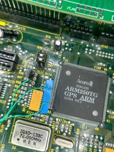

Getting the multimeter out I started testing continuity around the area of concern and my fears were confirmed not just one or two broken tracks but multiple broken tracks usually as it joined a pad

Most of the track damage was around the parallel port, battery position, and FDD socket.
The worst area to fix was the parallel port, and to be honest, it's one part of the machine I've not been able to test, but the continuity all tested good. The repair doesn't look great but it's functional so I'm happy
I also attached the Amiga-kit parallel port, and although not a perfect fit, it does the job.
I think I was lucky because I could find 3 tracks damaged from all these tracks in the picture which I was able to repair with 3 red wires
The battery area required links in all its positions due to the damage caused
Due to the amount of battery corrosion seen on the floppy connector and due to non-connectivity with tracks going under it, I removed it and ordered a new one, repairing the 4 tracks which were damaged.

Upon testing, my work seems all good and the CMOS battery is functioning as it should keeping the required data for next boot.

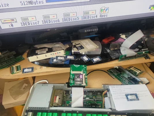

I also got a 4MB ram upgrade and fitted this to give it an extra boost now Dune II runs without the not enough memory issue

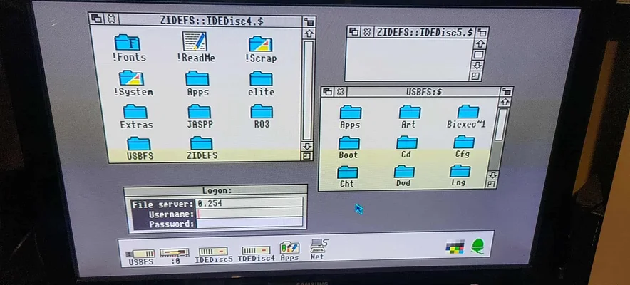

Next will be to upgrade the old HDD to a SD or CF drive.
