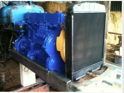

As some of you may know , my brother has bought a farm and some machinery to go with it, one delightful purchase is a 1954 fordson major tractor.
now it does appear to of been dug out of a peat bog but thats just the result of 60 years outside in the rain.
However after buying the old girl and driving it ten miles down country lanes back to the farm it was clear that all is not well. The radiator leaked more water than the titanic and the brakes had almost seized on fully, the sight of the ford going at 10mph with gallons of water escaping from a corroded radiator and smoke bellowing from the brakes was indeed a joy on a summers eve.
Anyway , the old girl worked all summer , cutting , hay making and drilling post holes but it was pretty obvious that serious issues were waiting around the corner.
So i bought the tractor a new (recon) radiator and under full pressure we can see that the block / head was leaking and worse the water from the water jacket was being forced in to the oil.

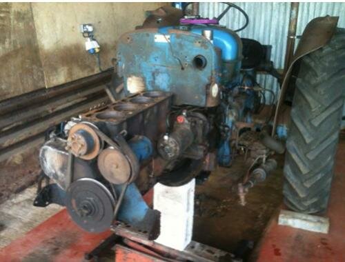

So we stripped the engine and well... its dead jim
The block is cracked completely (early blocks are weak) and the crank is worn , one piston is picking up and the block is corroded so badly it is leaking water around the throttle shaft.
So what to do...
Fit a 6 litre, 6 cylinder low milage former boat engine ... obvious really.
more details and tractor diary on the way as the build continues :-)

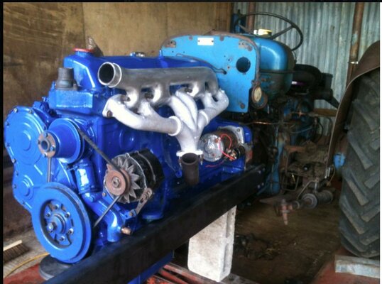

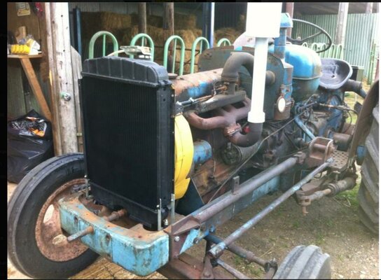

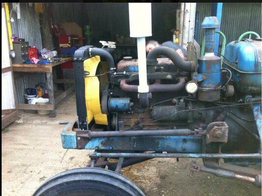

Okay next update.
The engine now fitted is a d series 1960s ford six cylinder which as luck would have it, is a like for like fit on the fordson bell housing. The only issue is that the sump is a different shape and the holes no longer line up but as it's an Ali sump anyway this isn't much of an issue.
So after many hours of fabricating , drilling and welding we have made the following parts , 2 chassis rails , from x member , extended steering arm , front axle pivot mounting.
The chassis rails are a pig to locate and line up properly , we had 3 goes at this and it still isn't perfect but it's pretty close. The x member under the engine was interesting to make as it required some angles and good guessing to get right but we did it. Now the front pivot on the axle which can be seen in the video required some heavy gauge fabrication and welding as most of the engine weight is on this and of course the steering but as you can see after 12 hrs of welding we called it a night as it was dark and about 3 degrees ...
But the next morning we fitted the new radiator and my bro drove it out of the barn for the first time in 2 months...
Lots to do yet... After this video he lined to the chassis rails again and adjusted the engine height on the x member. I need to repair the cowl and bonnet next and get some tidying of the bodywork done...
http://m.youtube.com/watch?v=ezgHWufB3AI
Mike
