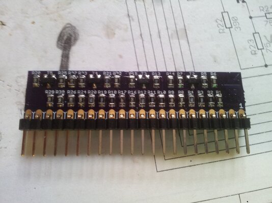

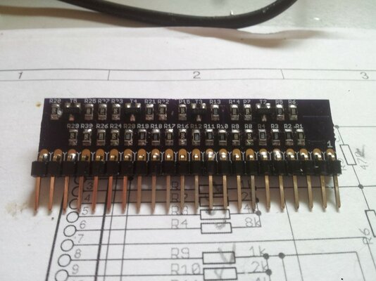

Hello there,
I'm offering 60 videohybrid replacement kits.
They can be used to replace a broken videohybrid or for the GBA1000. They are equivalent to revision -03.
Please check the parts on arrival:
Code:
100nF Kerko      -  [FONT=Arial]without marking, brown ceramic[/FONT]
MMBT3904 NPN     -  [FONT=Arial]marked[/FONT] 1AM5/1E
MMBT3906 PNP     -  [FONT=Arial]marked[/FONT] 2AZ
2x   36 Ohm      -  [FONT=Arial]marked[/FONT] 36R0
8x   75 Ohm      -  [FONT=Arial]marked[/FONT] 75R0
2x  220 Ohm      -  [FONT=Arial]marked[/FONT] 2200
3x  390 Ohm      -  [FONT=Arial]marked[/FONT] 3900
3x  470 Ohm      -  [FONT=Arial]marked[/FONT] 4700
1x 13k3 Ohm      -  [FONT=Arial]marked[/FONT] 1332
1x  150 Ohm      -  [FONT=Arial]marked[/FONT] 1500
4x   1k Ohm      -  [FONT=Arial]marked[/FONT] 1001
3x   2k Ohm      -  [FONT=Arial]marked[/FONT] 2001
3x   4k Ohm      -  [FONT=Arial]marked[/FONT] 4001
1x 6k04 Ohm      -  [FONT=Arial]marked[/FONT] 6041
1x   8k Ohm      -  [FONT=Arial]marked[/FONT] 8061
[B]1x 19k6 Ohm      -  [FONT=Arial]marked[/FONT] 1962[/B]
1x  27k Ohm      -  [FONT=Arial]marked[/FONT] 2702
2x 37k4 Ohm      -  [FONT=Arial]marked[/FONT] 3742
[B]1x 90k9 Ohm      -  [FONT=Arial]marked[/FONT] 9092[/B]
Pricing:
2,50€ for 1 kit
1,50€ for 1 spare pcb
3,70€ for shipping in Europe/worldwide
Bank transfer and PayPal only!
If you want to sell the kits (soldered or not) again rightaway, please keep in mind, that I do this in my spare time with next to no profit!
I hope, I haven't forgot anything...
Greetings,
crasbe

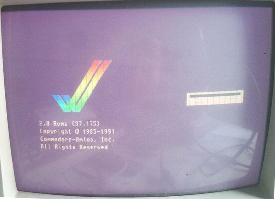

Hello Crasbe,
i am not interested, but can you explain the third picture on your post? There is some black columns on the kickstart screen.
Regards
Stefano
Oh, yes. I forgot that one... That's a faulty Denise in my test-A500+.
I don't know, how to proof it... I crosstested it with the Denise of my GBA1000 and there are no columns present.

I forgot to mention it: Please check all resistor-values. Especially the black marked ones in the table.
If you have wrong values, nothing will be damaged, but the picture will look somewhat ugly ;)
Edit: Of course, I will ship the correct resistors for free.
