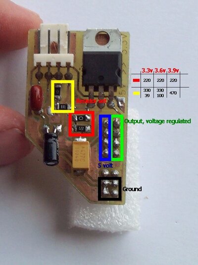

Interested in one please. Changing the voltage is just a matter of moving a jumper, right?
Hello,
i have made a different solution (to be honest, a jumper solution was not in my mind): you need to desolder a couple of resistor and solder other one. There is a page of instruction sent with the card, that explain all the possible combinations. All the resistors needed are in the package.
Regards
Stefano

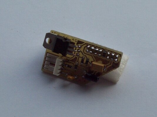

here a picture of this device: the withe connector is a standard molex connector with this input (from left to right)
+5v Ground Ground +12
Regards
Stefano

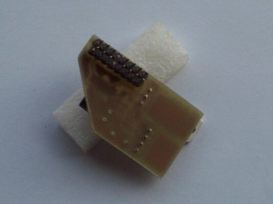

Hello,
the part is ready and tested only attached to a common psu. It will be shipped with a set of resistor to obtain the three value of 3.3 - 3.6 and 3.9 volt (this last values are needed if you wish a 060 overclocked!).
More on PM.
Regards
Stefano
