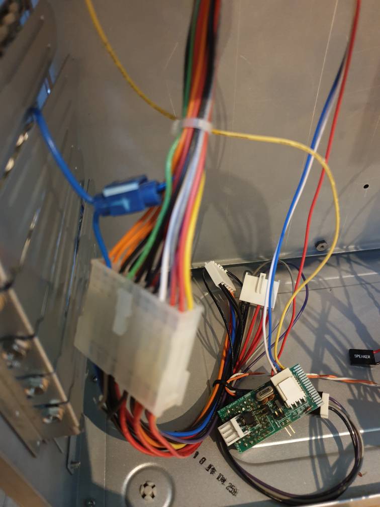

Well, just to update where this all got to:
I have a ratte switch fitted and all working and it does its job with my monitor so I dont have to change source or anything when playing games.
Sound is via a small bluetooth transmitter from the line out from the sound card and powered from the psu in the tower.
Finally -this took lots of effort - I have warp3d working as well although need to play with some settings to make things smoother.
I was having regular issues with Miami although I dont know why as it works fine on my other miggy, maybe it just doesn't like the hardware. Anyway, I bought roadshow which does actually seem faster as well.
Still got a few things to work on but am getting there.
