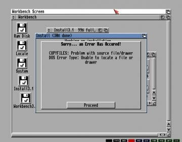

"Clean disks", but still they're corrupted somehow.
This is a novice install mode(same happend in expert) of Norwegian OS3.1
Grrr
Those were the Escom disks, with the Commodore disks it works just fine... Does anyone else have escom disks and can confirm a norwegian install?

what are you installing to? hard drive? CF?
are these new copies of the original? does the error happen in the same place each time?
These were my adfs of the disks, installing under WinUAE to a CF card
Hmmm, it says 99% full, so maybe the disk is full?
Maybe the file already exists?
Maybe it is write-protected?
Maybe the drawer doesn't exist? ;)
Been a while since I did that/ my 60GB SFS drive works since ~2003 so I don't remember much...
EDITED: Oh, right, it says 99% full on the WB3.1 installation disk, got it ;)
I think I know what it is... :-S grrr
I forgot to set max transfer right on the CF card.... So files written to "System:" volume got corrupt.
re-wite the failing disk to a new disk using ADF2DISK, also check the speed settings on your CF card
